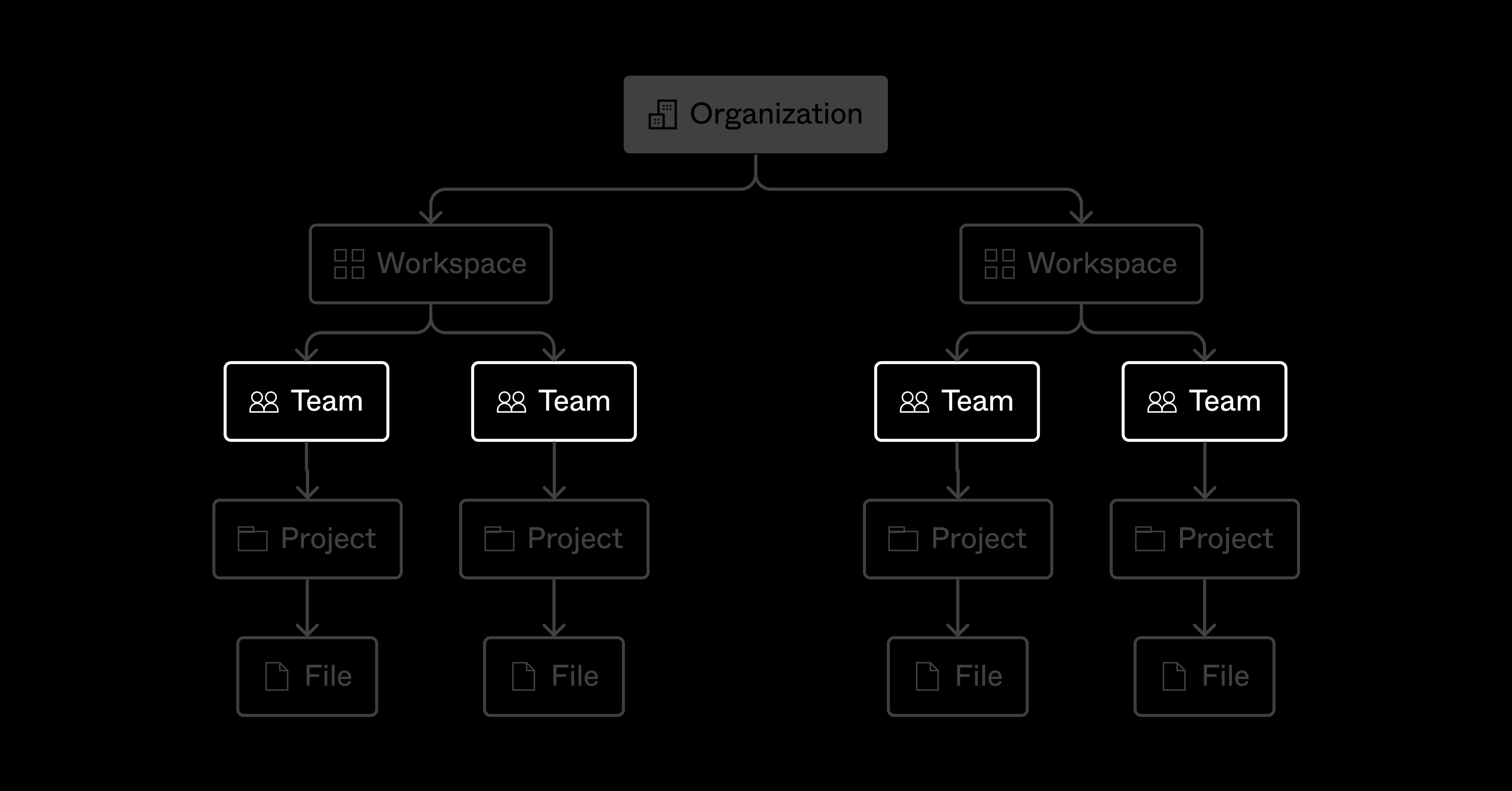

How to structure teams in Figma
A visual representation of the Figma organization structure. From top to bottom, the labels read: "Organization," "Workspace," "Team," "Project," "File." Everything apart from "Team" is transparent, bringing "Team" into prominence.A visual representation of the Figma organization structure. From top to bottom, the labels read: "Organization," "Workspace," "Team," "Project," "File." Everything apart from "Team" is transparent, bringing "Team" into prominence.
Within Figma, teams can have three types of permissions: open, closed, and secret.
Open is a fully transparent team that anyone in your organization can join at any time. This is best for most situations, and encourages an open design culture.
Closed requires a request from your colleagues before they can join, which is ideal if you want to limit who’s making updates to your designs.
Secret teams are exactly that, as they prevent your entire organization from seeing what you’re working on; only the team creator and editors have access… perfect for that surprise project you’re cooking up.
Despite being called teams, these permission types can be a great way to separate workstreams within your organization. If you don’t know where to start, try setting up teams in Figma by mirroring your product team’s structure. For example, your organization might be split into platforms, like web, iOS, and Android—all guided by an overarching design system. By allowing your different disciplines to work independently within their own Figma space, you can operate as transparently as you need. If, say, the iOS team requires the creation of a secret team while the next version of the product is being released, that can be managed independently from the rest of your Figma teams.
Teams can also be useful for larger groups that look after separate, more complex projects. At Figma, we’ve set up teams for each part of our product, like prototyping, design systems, collaboration, and so on. This encourages a workflow in which our central design system is consumed by different product teams that all share our Figma components and styles library.

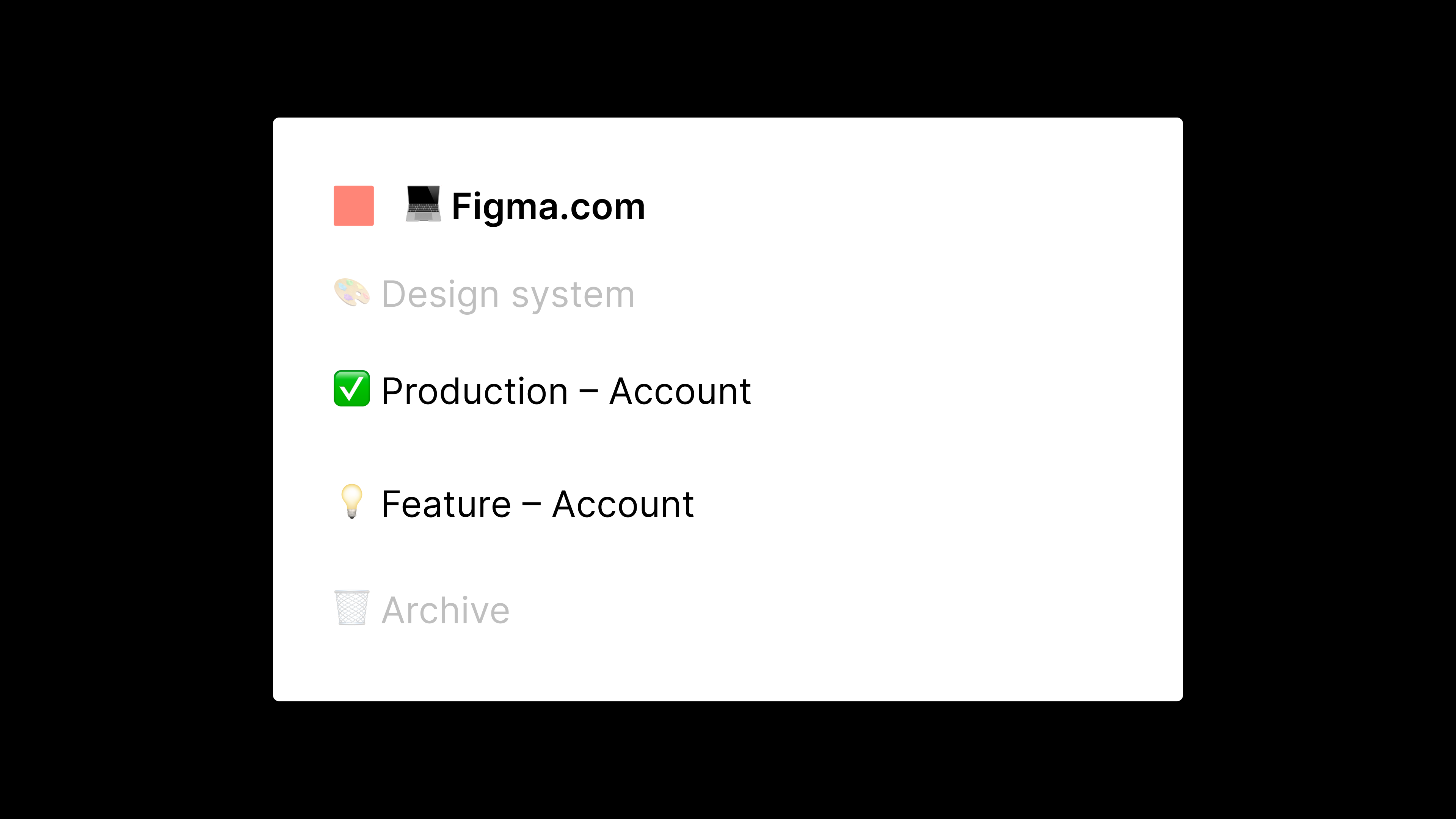

By feature or production state
Organizing by production state is best for teams that require visibility into what's "live" and what isn't
A mockup showing a Figma team and project arrangement. The team is called "Figma," and the projects are "Design system," "Production - Account," "Feature - Account," "Archive." All of the projects apart from "Production - Account" and "Feature - Account" are transparent, bringing prominence to these two.A mockup showing a Figma team and project arrangement. The team is called "Figma," and the projects are "Design system," "Production - Account," "Feature - Account," "Archive." All of the projects apart from "Production - Account" and "Feature - Account" are transparent, bringing prominence to these two.
This is useful if you want to create a more transparent approach to sharing the status of a feature. For example, if you manage permission access to files on a project basis, or you aren’t using branches to manage workflows, you can create projects for each product’s user flows. Then, you can split these further into work that is “production” (designed, signed off, and developed) and work that is a “feature” (currently in progress).
So, what does that look like in practice?
Inside “Production“ projects, you might have a complete, approved user flow (or multiple flows, depending on product scope). Anything that is live on the app, website, or product would live here. You might update it on a regular cadence that maps to how you release work, perhaps monthly or quarterly, depending on the complexity of your product.
Inside “Feature” projects, you might house smaller feature files so that each design task has a dedicated file.

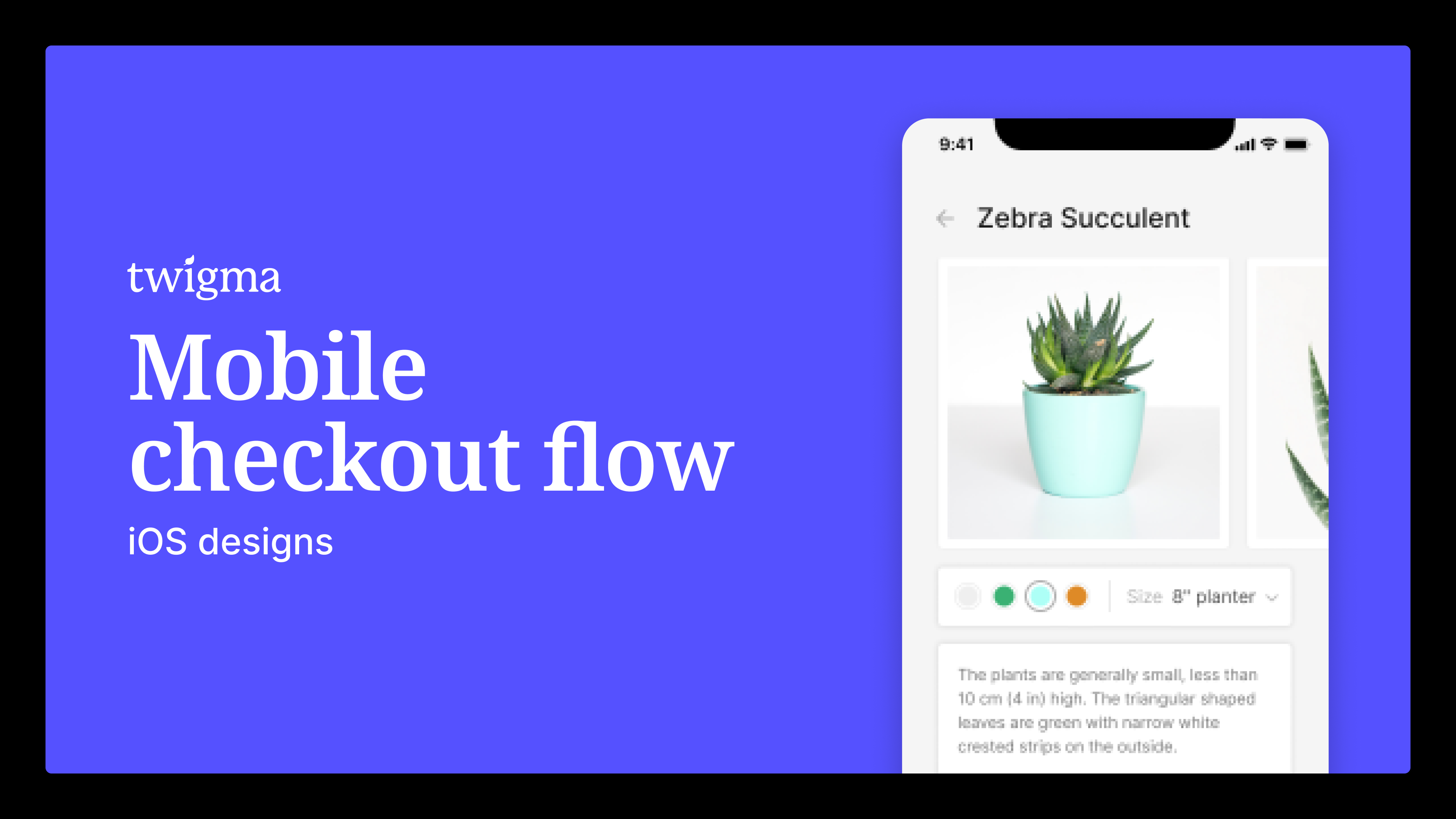

This community file shows you what the workflow would look like.
Note: You could also use branching instead of creating brand new files for ticket workflows in project management tools.
An isolated Figma thumbnail, for a file named "TWIG-813 - Button a/b test."An isolated Figma thumbnail, for a file named "TWIG-813 - Button a/b test."

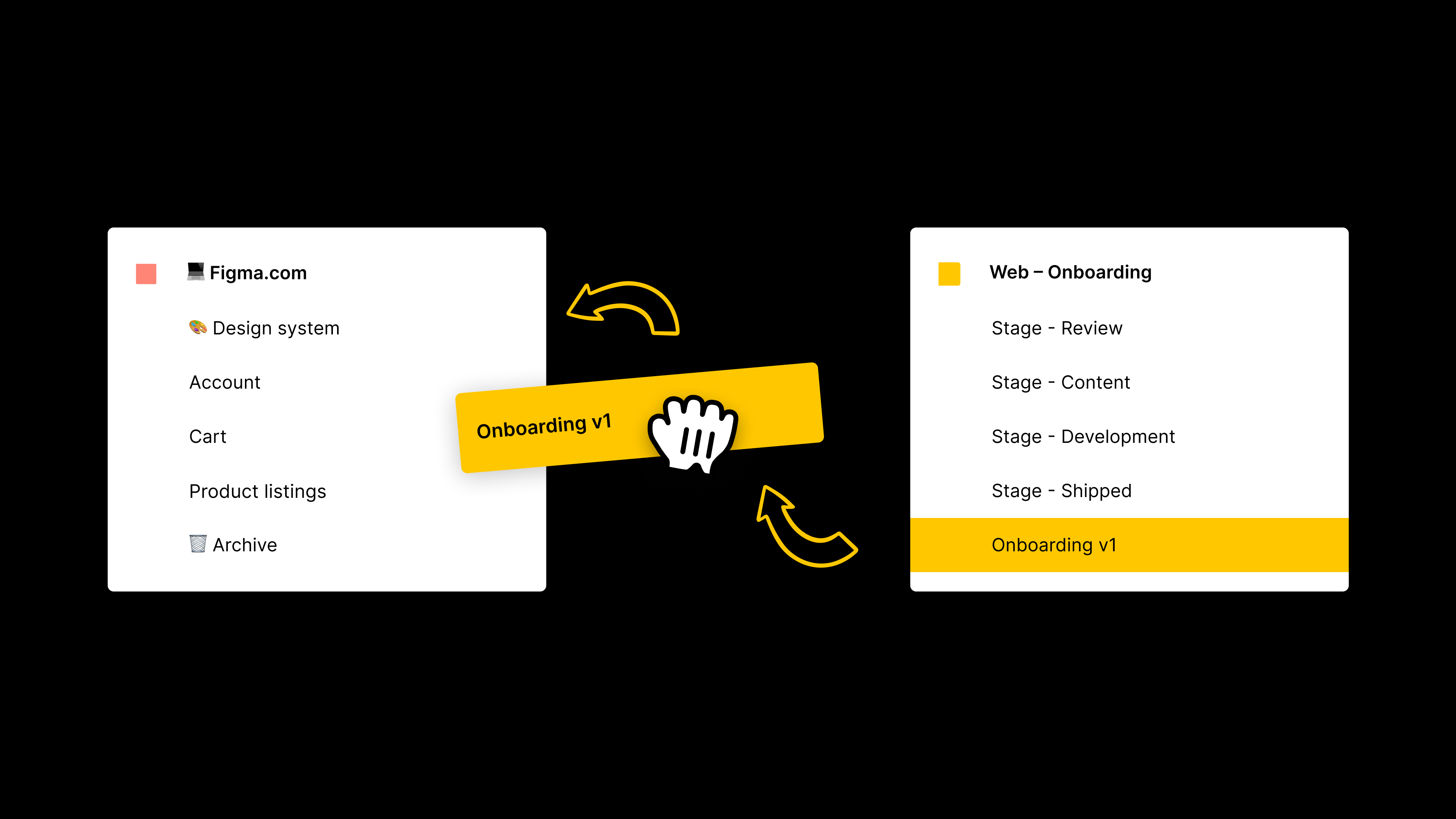

Within these projects, you can create files as normal and then drag and drop them into other projects in the file browser. It’s a great Easter egg—once you find it, you’ll start to love the power.
A visualization of a Figma file being dragged from one project to another.A visualization of a Figma file being dragged from one project to another.
There is the additional benefit here of having project-level permissions. You can invite individuals to projects, which creates an extra level of control over what people see in your designs. For example, if you want developers to only see files when they are in the Shipped project, you can do that.

Even though projects live within teams, you can move them to other teams by dragging and dropping. Bear in mind that if you move a project to a new team, file permissions within the project may change.
A visualization of a Figma project being dragged from one team to another.A visualization of a Figma project being dragged from one team to another.

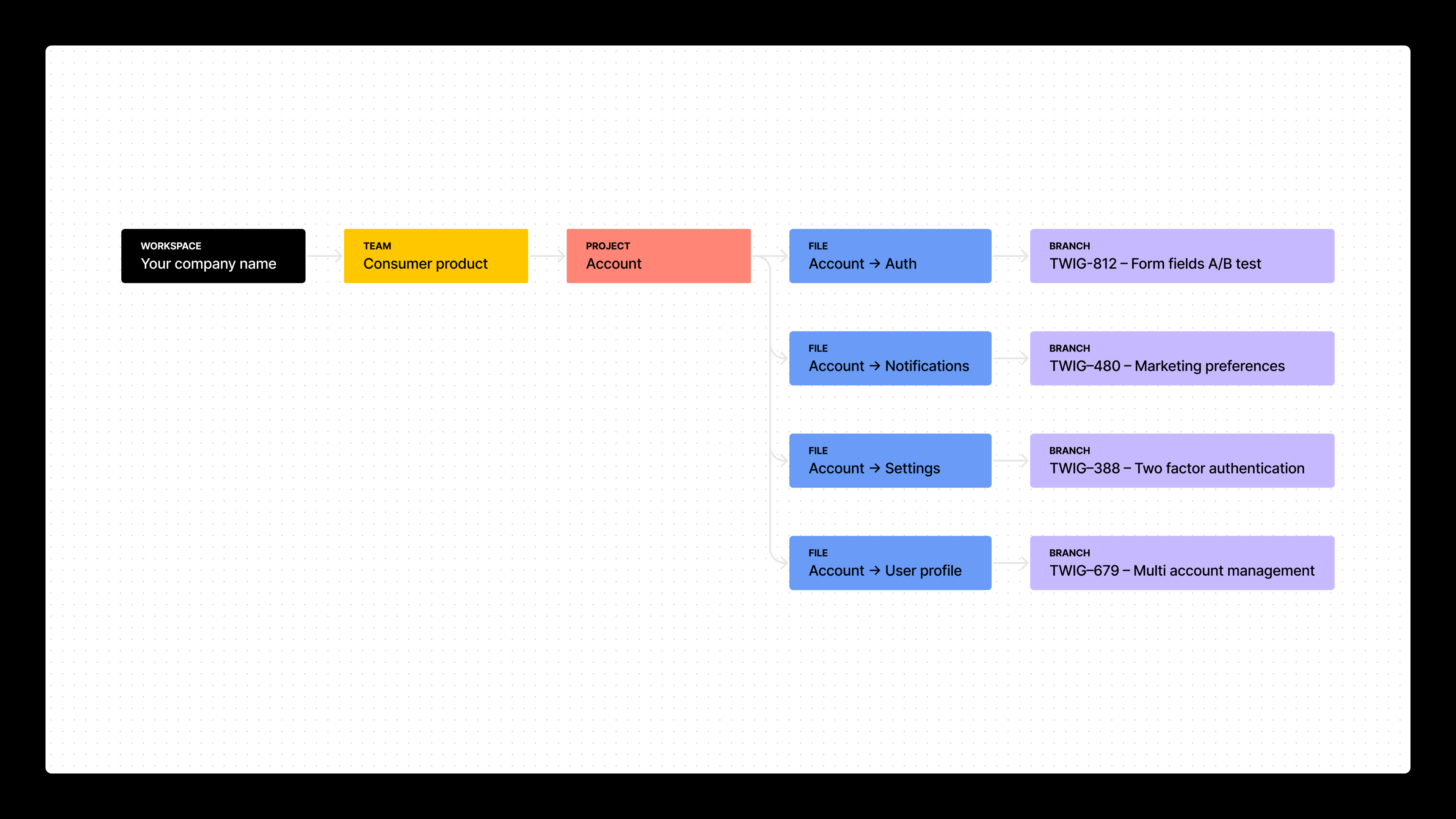

Depending on which project structure you opt for, a strong naming convention could look something like this for a web project:
A FigJam mockup of an example Figma team, project, and file setup for a team called "Consumer Product," and with a project called "Account." There are sample files within the product, titled "Account -> Auth," "Account -> Notifications," "Account -> Settings," "Account -> User profile,"A FigJam mockup of an example Figma team, project, and file setup for a team called "Consumer Product," and with a project called "Account." There are sample files within the product, titled "Account -> Auth," "Account -> Notifications," "Account -> Settings," "Account -> User profile,"
And here’s how that may look for a software product. For example, Figma!
A FigJam mockup of an example Figma team, project, and file setup for a workspace called "Figma product," teams called "Collaboration" and "Editor," and sample files within these to simulate how the Figma team organizes their workspace.A FigJam mockup of an example Figma team, project, and file setup for a workspace called "Figma product," teams called "Collaboration" and "Editor," and sample files within these to simulate how the Figma team organizes their workspace.
Files pair really nicely with our projects, so you can extend the naming to make them easier to find and understand.
Pro-tip: There’s a very neat feature within file names whereby if you type a hyphen (–) followed by an arrow (>) it automatically turns into an arrow (→). Cool, huh? It even works backwards, in case you need your arrow to point left!

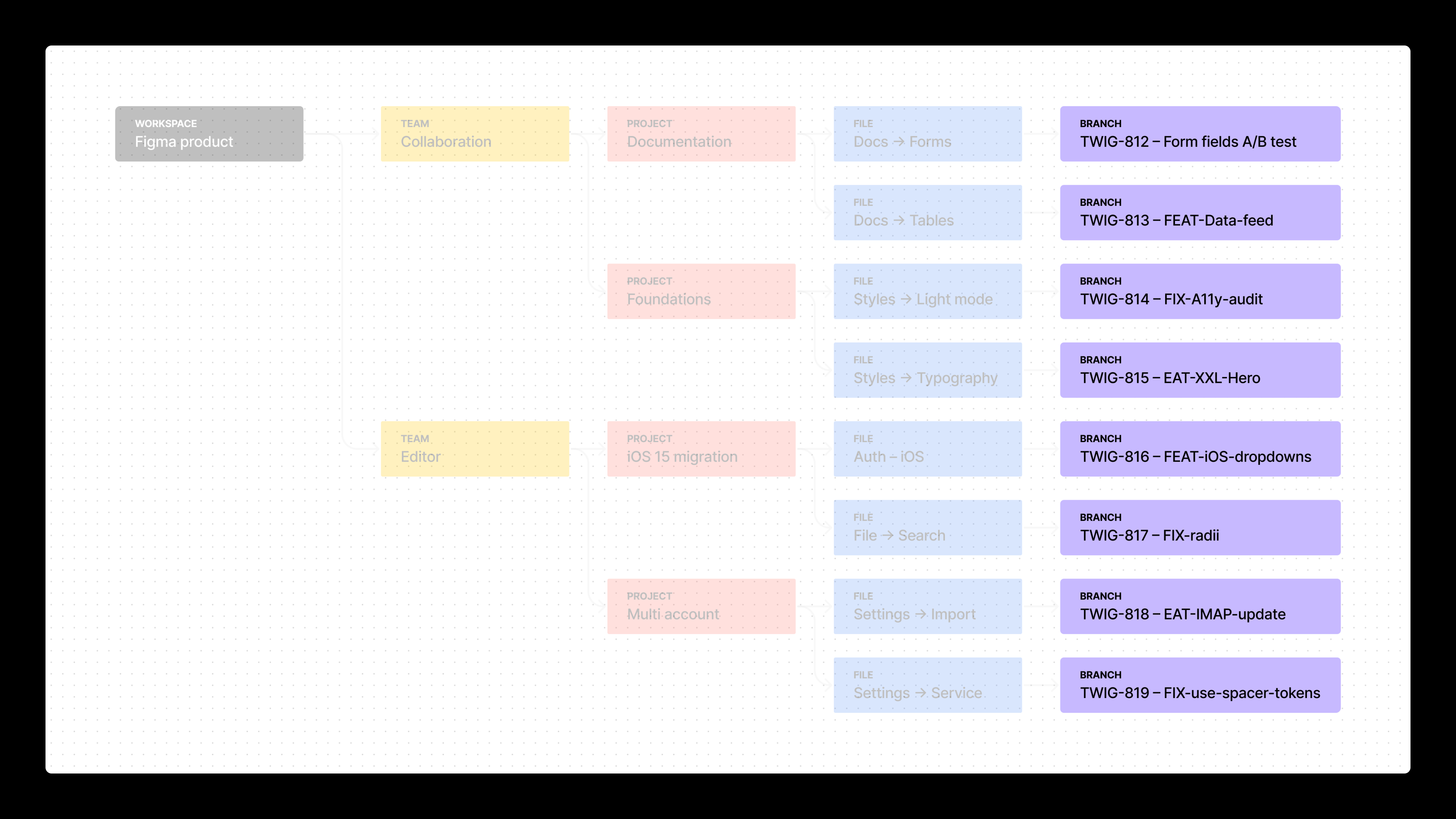

If you manage your designs with project management software, you may want to follow a ticketing system with your Figma files, too. With this in mind, you could compose Figma file names that align as well. For example, a file (or branch!) named TWIG-812 – Form fields A/B test to match the task name.
A FigJam mockup showing a series of example branch names. For example, "TWIG-812 - Form fields A/B test," and "TWIG-813 - FEAT-Data-feed."A FigJam mockup showing a series of example branch names. For example, "TWIG-812 - Form fields A/B test," and "TWIG-813 - FEAT-Data-feed."
Or you might work with a combination of the two! Following the feature or production state approach, you could end up with file names that are different depending on whether they are "Production" or "Feature" files, as demonstrated here:

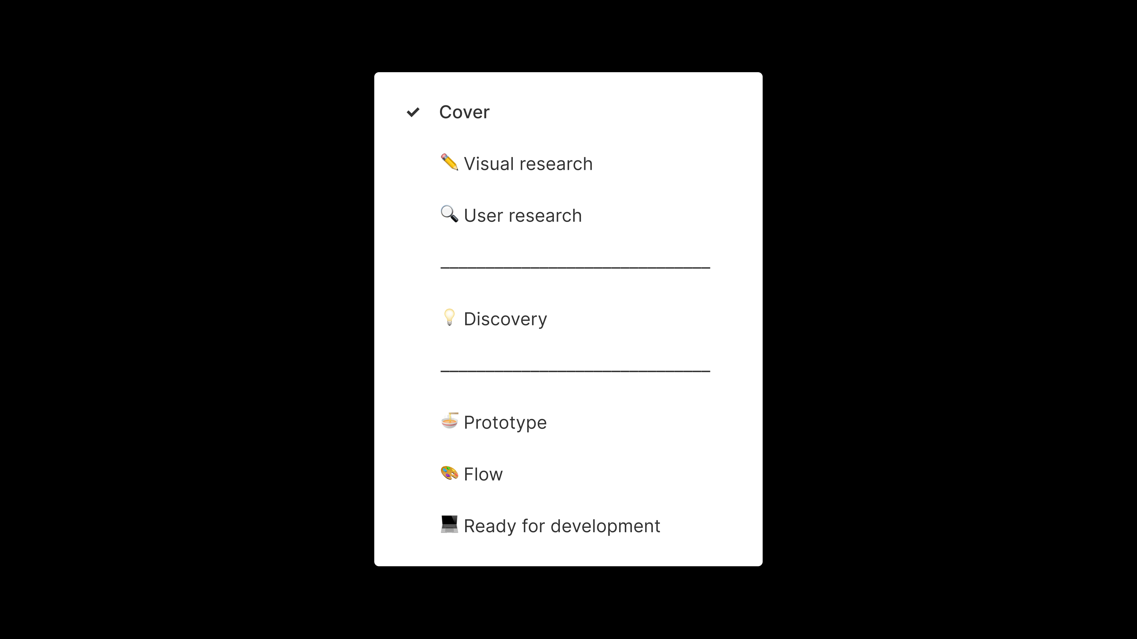

The page structure of dreams consists of:
  • Cover: Where you keep the thumbnail of your file so that it’s discoverable in the file browser.
  • Visual research: A home for all those wonderful screenshots you use as inspiration.
  • User research: An optional space for user testing flows and concepts.
  • Discovery: Where you flesh out ideas and store your (amazing!) rejected ideas.
  • Flow: How you pull together formalized ideas into a structured user flow for feedback.
  • Prototype: An optional page showing micro interactions and click-throughs of work. Why is there a separate page for flow and prototype? Prototypes typically require duplications of screens for animations (a series of screens for your loader, for example) and that could be confusing to stakeholders. Keeping things separate helps you be more intentional with file organization.
  • Local components: A page including components specific to this file (e.g. a carousel that’s only used on this individual screen). Knowing that you should keep components at a more global, design systems level, this page is optional unless you do need components specific to this piece of work.
  • Ready for development: Once you’ve gotten sign-off from key stakeholders, organize your work here. It’s good practice to keep everything that has been signed off and shipped in a separate location from work in progress files—you don’t want to use the wrong asset in production!
A screenshot of a Figma page structure. The pages read "Cover," "Visual research," "User research," "Discovery," "Prototype," "Flow," and "Ready for development."A screenshot of a Figma page structure. The pages read "Cover," "Visual research," "User research," "Discovery," "Prototype," "Flow," and "Ready for development."
If you want to uplevel your page structure, you can even include spacer pages in your side panel so that there’s a clearer distinction between phases. These are created using a series of hyphens in the name of the page–simple, but effective!
A screenshot of a Figma page structure. The pages listed read "Cover," "Visual research," "User research," "Discovery," "Prototype," Flow," and "Ready for development." There are separators between "User research" and "Discovery," and "Discovery" and "Prototype."A screenshot of a Figma page structure. The pages listed read "Cover," "Visual research," "User research," "Discovery," "Prototype," Flow," and "Ready for development." There are separators between "User research" and "Discovery," and "Discovery" and "Prototype."
Wait, wait, wait. Where are the emojis? Let’s jazz this thing up.
A screenshot of a Figma page structure. The pages listed read "Cover," "Visual research," "User research," "Discovery," "Prototype," "Flow," and "Ready for development." Each page title has an emoji alongside.A screenshot of a Figma page structure. The pages listed read "Cover," "Visual research," "User research," "Discovery," "Prototype," "Flow," and "Ready for development." Each page title has an emoji alongside.
As this is just a guide, your page skeleton may differ significantly, and that’s totally okay. Every company is different, and you may end up with a smaller or larger base structure for your organization.
Branching
Branching can make file management a lot easier in the long run, and ensure that you’re all working within the correct “main” file at all times.
A visualization showing a Figma file and a branch.A visualization showing a Figma file and a branch.
An example may help here!
Let’s say you have a team for your consumer app, a project for the Account section of your app, and a file for the Account → Auth designs. If you need to work on a new feature like Add new form fields to the authentication flow, you could use branches to manage the design updates.
If one designer is responsible for each feature, you could create a branch for each distinct update, managed independently. For example, in this instance you’d create a branch named TWIG-812 → Form fields. TWIG-812 refers to the ticket number from your project management software, like Jira, Asana, Notion, Monday.com, Linear, and so on. You can see a full list of Figma integrations here.
Each designer would work within their own branch, testing out their ideas, gathering feedback, creating prototypes, and ultimately pushing it through the development process. You could invite your developers into a branch as viewers, or even embed the branch into your project management software to browse.
Once the work has been signed off and coded up, you’d then merge your work back into the main Account → Auth file, add a named version into the version history with a date and description of the work completed, and move onto the next feature.

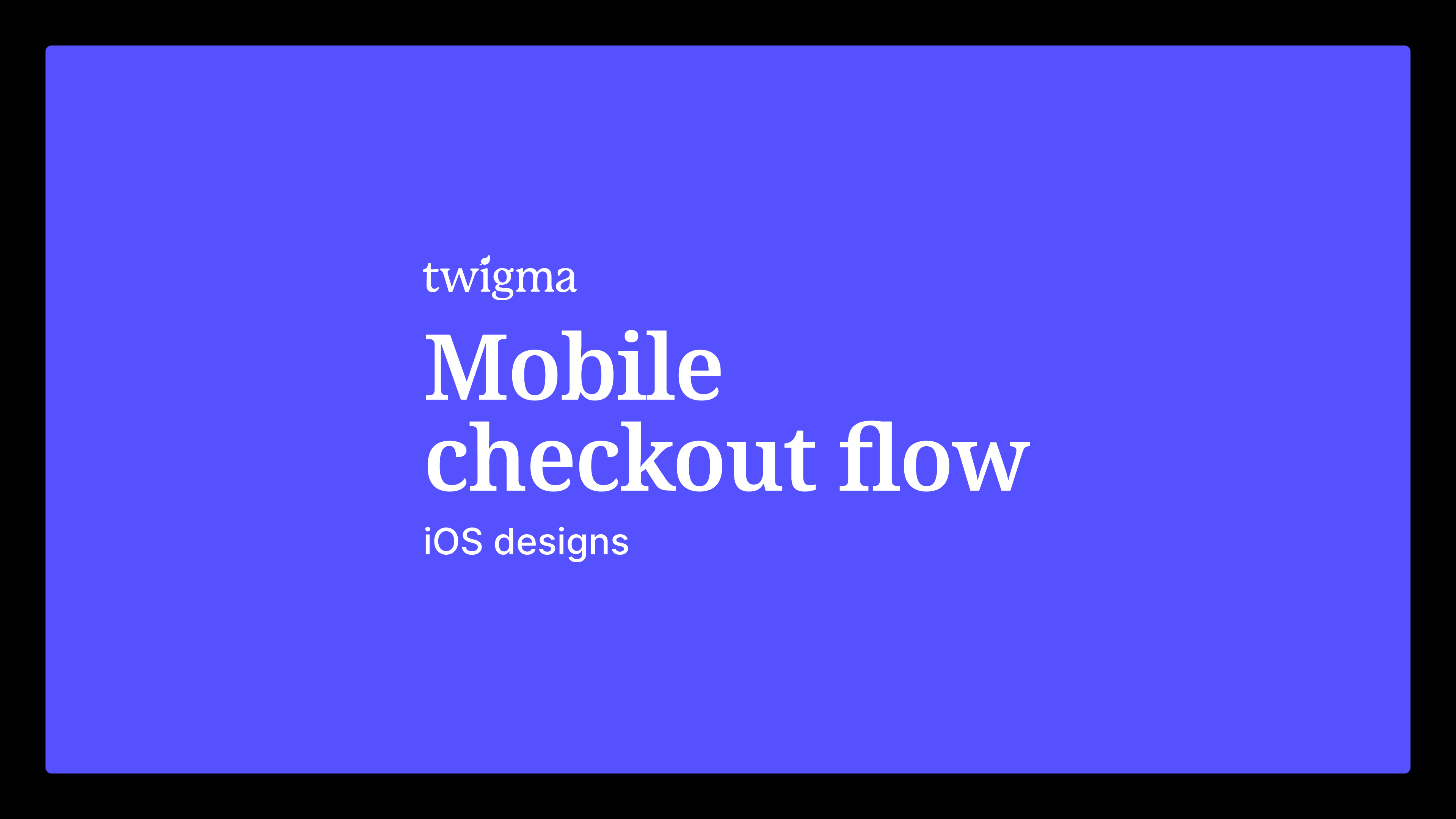

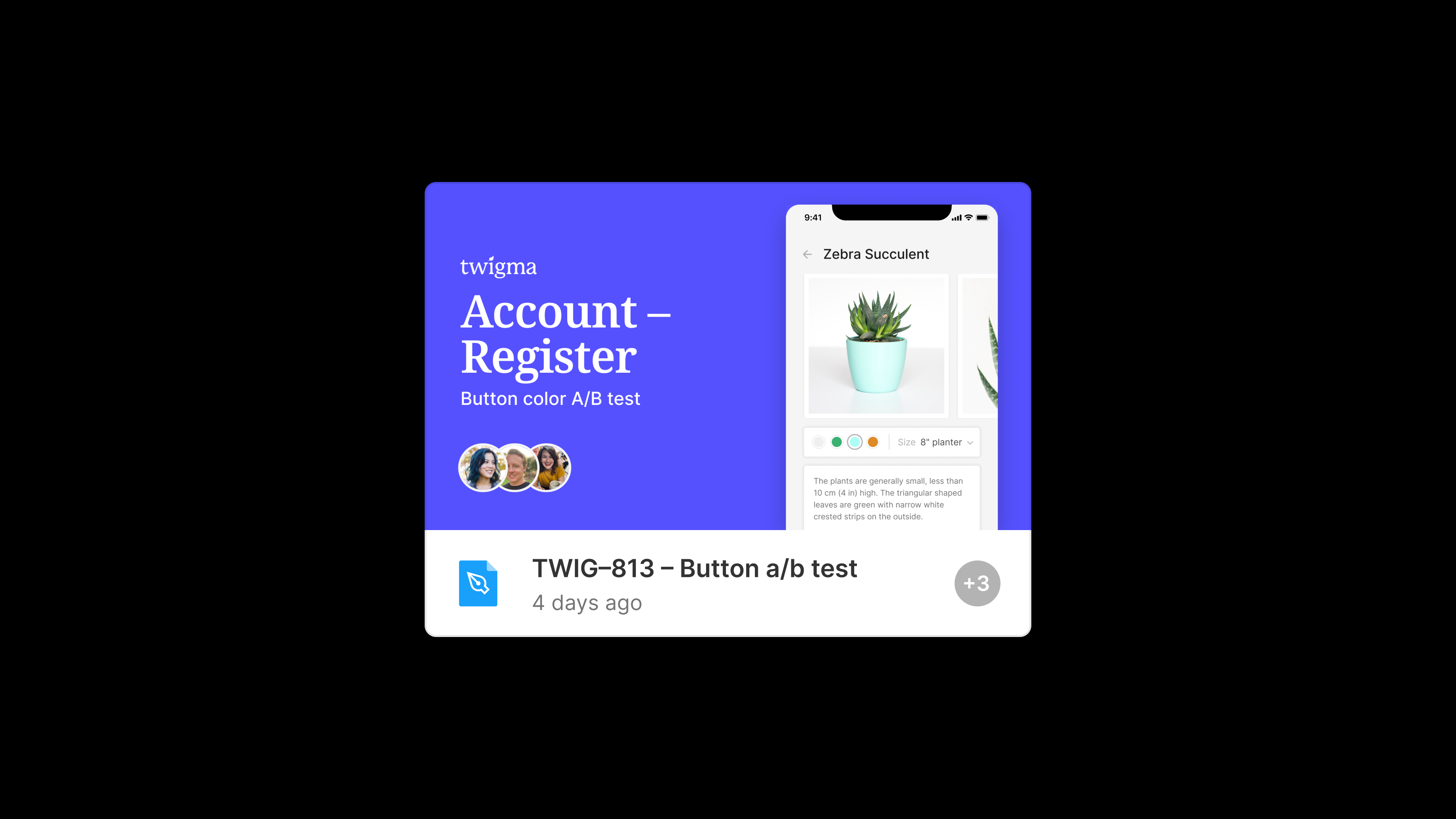

Cover pages
Cover images are great for making files for discoverable. You can design these however you wish, but keeping a consistent structure is key.

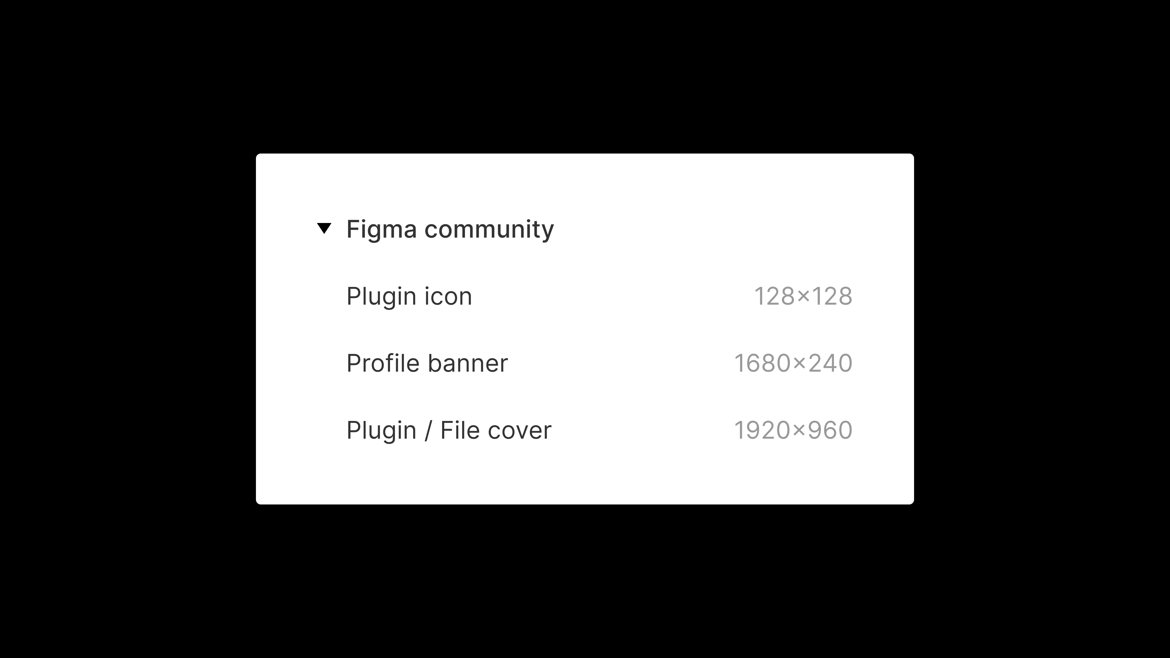

To set up a cover image, create a new Frame on the canvas using the Plugin / file cover preset in our Figma Community section, illustrated below.
A screenshot of the Figma frame size options for "Figma community."A screenshot of the Figma frame size options for "Figma community."
Once you’ve added a cover frame, you can design it! At the very least, it makes sense to include details like the file name, and a short description of its contents.
A sample Figma cover page design.A sample Figma cover page design.
Extending this, you might include a screenshot of the work inside the file. This can help if you have lots of files with similar names.
A Figma file cover design, showing a screenshot of a mobile design alongside the title.A Figma file cover design, showing a screenshot of a mobile design alongside the title.
Some teams even indicate the status of their design work and information on the team that’s designing the feature too!
A Figma file cover design, showing a screenshot of a mobile design alongside the title, as well as circular avatars in a facepile arrangement.A Figma file cover design, showing a screenshot of a mobile design alongside the title, as well as circular avatars in a facepile arrangement.
There are endless options here, and you can add as much as you need to keep teammates and stakeholders informed. For inspiration, take a look at the Figma Community.

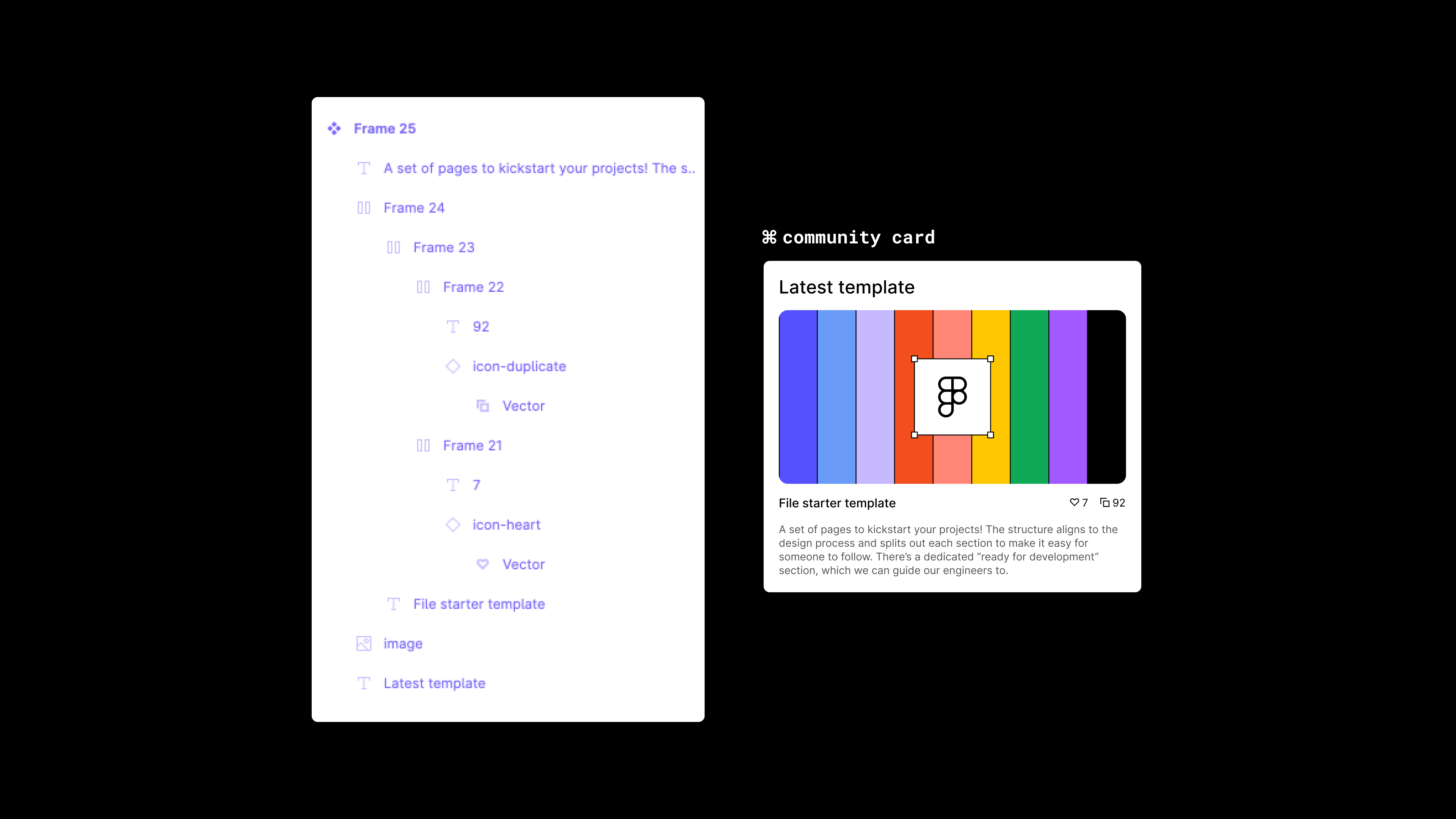

No layer names
A screenshot of the Figma layers panel, alongside a "card" component. The Figma layers do not have specific names.A screenshot of the Figma layers panel, alongside a "card" component. The Figma layers do not have specific names.
Design stage: Ideating
Owner: File creator
I promise you I’m not cheating here, this is a legitimate approach for teams (or individuals) that don’t need to rely on the layers to communicate their design decisions.
This approach is either something you’d limit to the ideation phase of your design process, or go all in if you communicate your decisions in other ways—perhaps with on-canvas communication, or with other types of documentation.
We’re just having fun at this stage, so you don’t need to pay too much attention to our layer naming or structure. Because this is still very scrappy, we don’t need to be concerned about naming or even using particular elements (maybe a rectangle is fine for a button!).

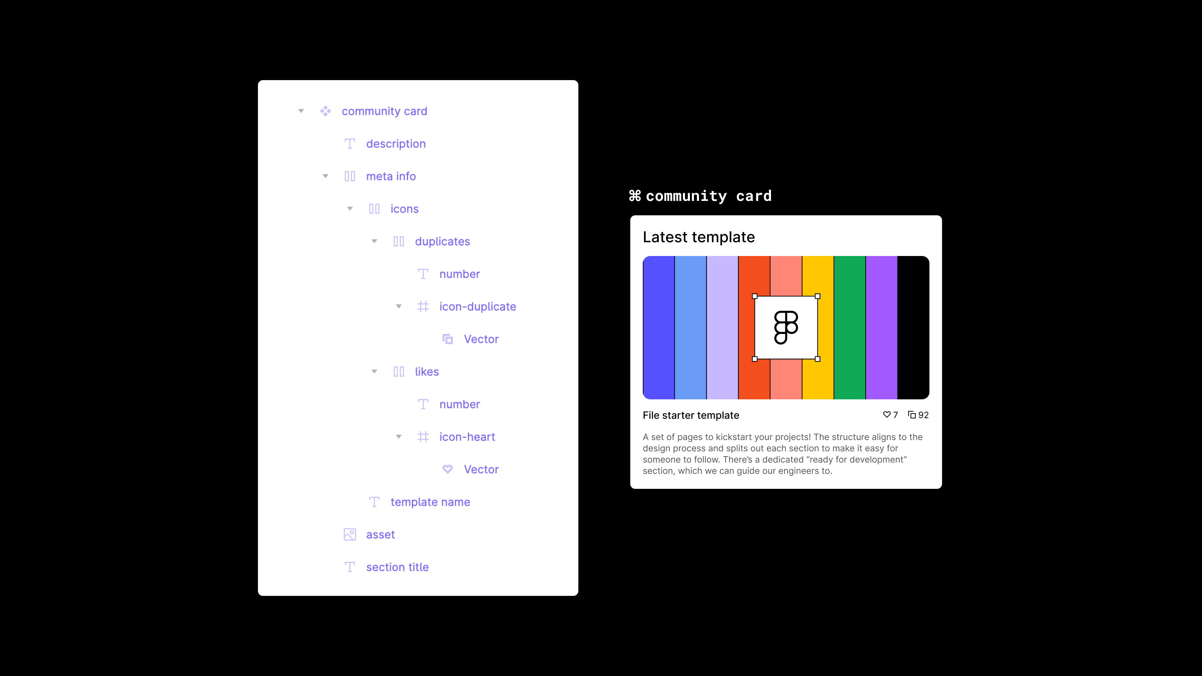

Refinement
A screenshot of the Figma layers panel, alongside a "card" component. The Figma layers have been titled in a descriptive way.A screenshot of the Figma layers panel, alongside a "card" component. The Figma layers have been titled in a descriptive way.
Design stage: Refining
Owner: File editors
Are you and your team preparing for sign off from your key stakeholders? This is where you should think about how easy it is for someone to digest your ideas and iterate on them. Clear layer names can really help here; call a card a card, a number a number, and a description a description. While individual designers are still owning their designs at this stage, layer names need to make sense to the rest of the team.

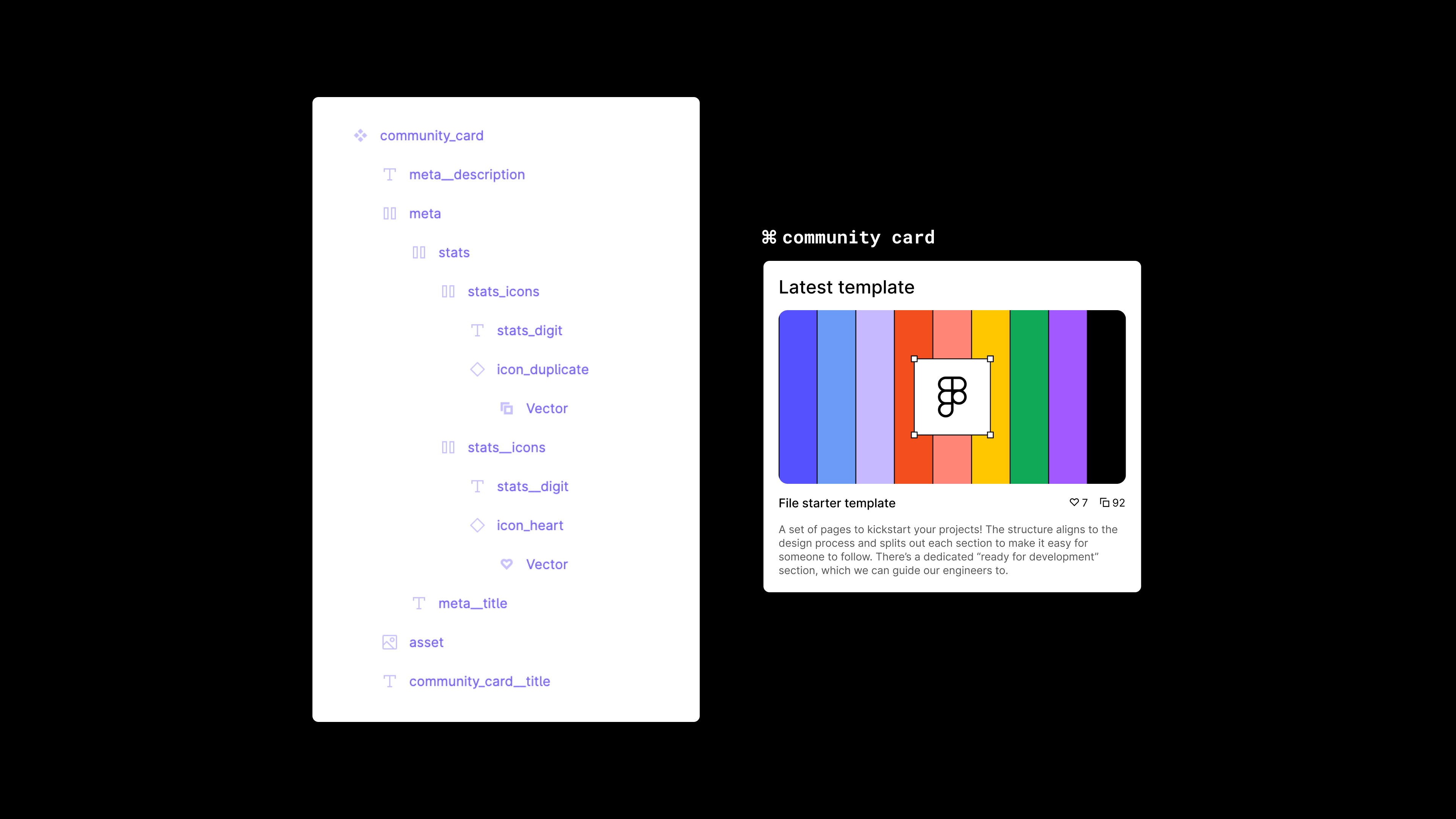

Aligning to code
A screenshot of the Figma layers panel on the left of the image, with a "card" component in the middle, and another screenshot of the layers panel to the right. The left version of the Figma layers has them named in the BEM style, with the right named in a way that matches HTML structure.A screenshot of the Figma layers panel on the left of the image, with a "card" component in the middle, and another screenshot of the layers panel to the right. The left version of the Figma layers has them named in the BEM style, with the right named in a way that matches HTML structure.
Design stage: Ready for handoff
Owner: Design systems team
This section will be split in two, with a Block Level Modifier approach and one aligning to HTML markup.
1. Block Level Modifier
A screenshot of the Figma layers panel, alongside a "card" component. The Figma layers have been titled to match the BEM style.A screenshot of the Figma layers panel, alongside a "card" component. The Figma layers have been titled to match the BEM style.
This concept borrows from engineering, and it helps you align layers to code so developers can quickly grasp how to structure their components.
2. Aligning to HTML
A screenshot of the Figma layers panel, alongside a "card" component. The Figma layers have been titled to match HTML structure.A screenshot of the Figma layers panel, alongside a "card" component. The Figma layers have been titled to match HTML structure.
If you’re building a web product, it might be worthwhile to name your Figma layers based on how they’d be presented in the frontend markup that your developers will be writing.
These are technical approaches, and are best handled once your components are in the correct Figma library, in a production-ready state. Any time before, and this would require too many small-scale changes to your layer structure, potentially causing more issues than they solve in the long run.
While designs are really never "finished," follow this structure when you're heading into production. It’s an opportunity to collaborate with your developers, as there’s no better design process than an open and transparent one. Since this method requires knowledge of markup language, it’s best for a technical designer or the design systems team to take it on.
If your team isn’t closely aligned with your engineering counterparts, you might consider a different approach; the naming only really makes sense if both teams use it.
Bonus: Merging a few concepts
What if we wanted to borrow something from each of these concepts? Using Figma’s component description field, you can meet these techniques in the middle and satisfy both design and engineering teams.
Like the more technical approaches, this is ideal for when you've already agreed on a component’s design and are moving it into the Figma library file. This way, you only need to set it up once, and publish it out to the wider team for usage.
With your design systems team closest to your engineering team, you can align the naming conventions, status, and any other important information with the correct engineers and then add it to your Figma component description.
Refinement is the easiest approach to scan and read for most teams, so let’s use it as a starting point.
A screenshot of the Figma layers panel, alongside a "card" component. The Figma layers have been titled to be descriptive.A screenshot of the Figma layers panel, alongside a "card" component. The Figma layers have been titled to be descriptive.
Extending the layer names

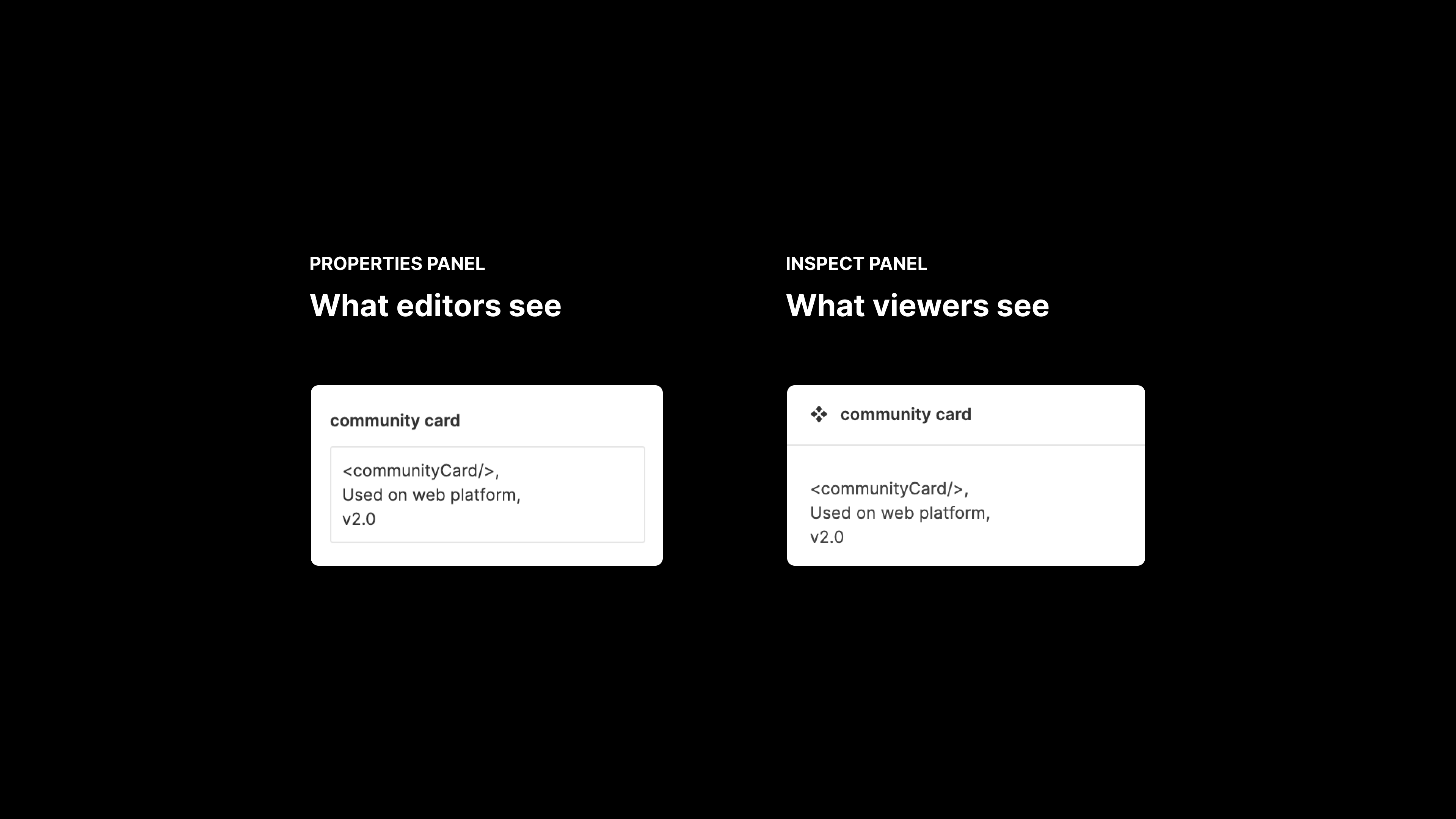

You can document your components using the description field to add notes about usage and appropriate naming conventions. This will appear both for designers (in the properties panel) and developers (in the inspect panel).
A screenshot of the Figma properties panel on the left, and the Figma inspect panel on the right. The title of the inspect panel section is "What editors see," and the inspect panel is "What viewers see."A screenshot of the Figma properties panel on the left, and the Figma inspect panel on the right. The title of the inspect panel section is "What editors see," and the inspect panel is "What viewers see."
Adding documentation to your components

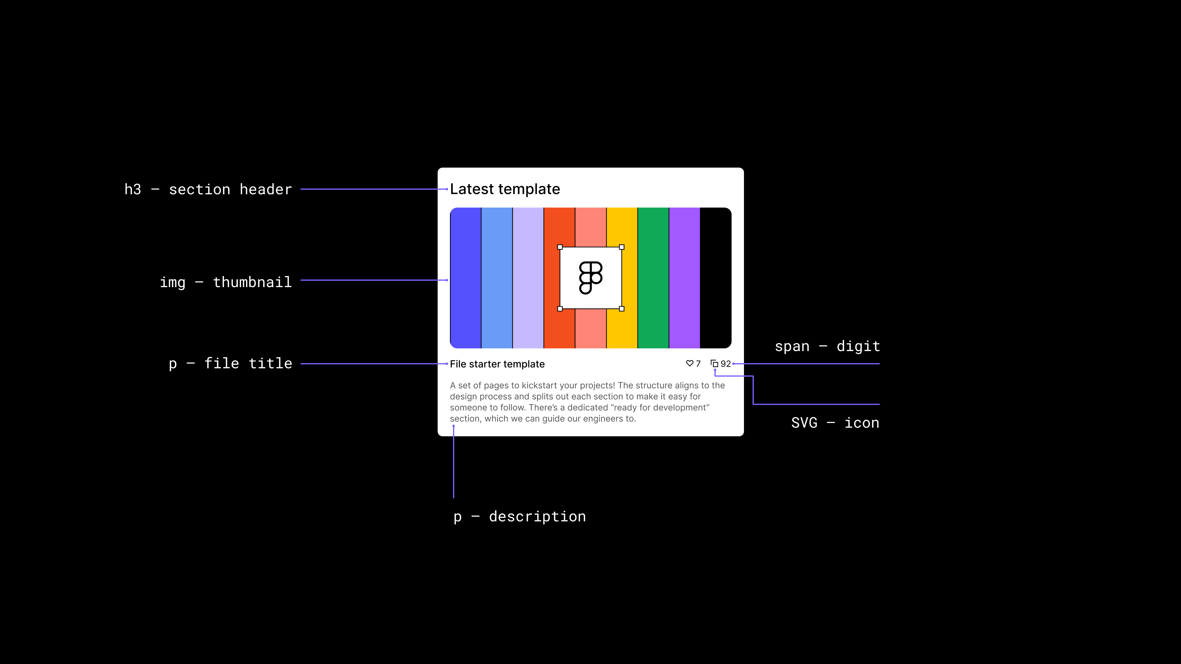

Because there are tons of different ways to implement designs, you can help your engineering team by adding useful annotations onto the canvas.
Note: Manage documentation in a separate file, so that you can maintain documentation and component versions in two separate places. This way, docs are always up to date, even while you tinker on new ideas.
The below is an instance component with manually-added notes that align to HTML.
A screenshot of the card component used throughout this section, with thin lines pointing to each unique element within the design, and a small title describing what the element is. For example, the line pointing towards the title has a label reading "h3 – section header."A screenshot of the card component used throughout this section, with thin lines pointing to each unique element within the design, and a small title describing what the element is. For example, the line pointing towards the title has a label reading "h3 – section header."
