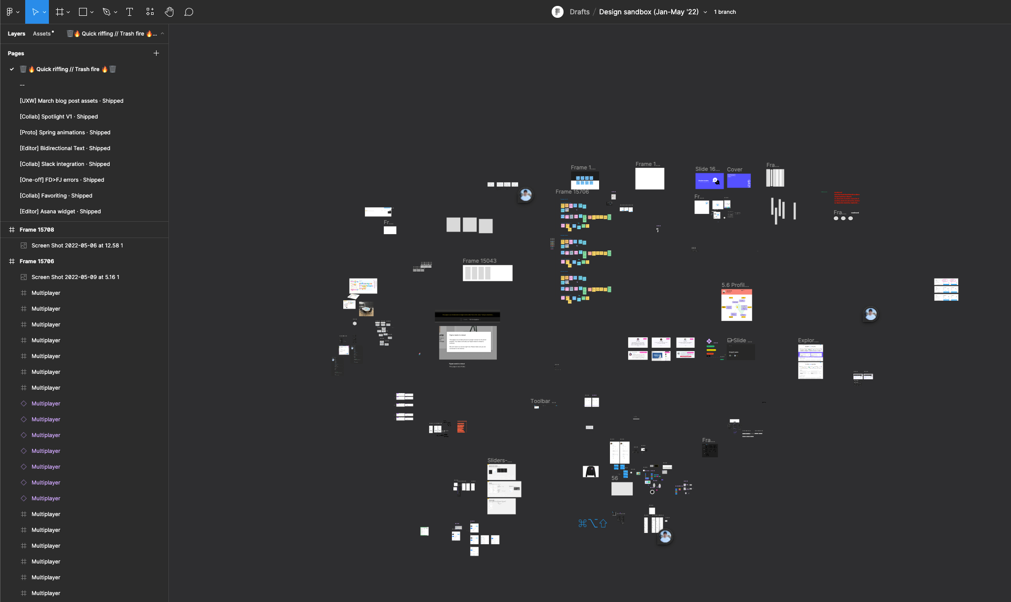

2. Create your own working file
Go this route if you prefer to let loose in private. In a separate file, you can get all those ideas—the good, the bad, the both-good-and-bad—out of your brain and onto Fig-paper. When you’re ready to share your best ideas, just drop a copy of them into your designer’s file—either in a dedicated copy page (like above), or adjacent to the relevant designs.
A Figma file showing pages on the lefthand side, and instructions on how to organize your file on the righthand side.A Figma file showing pages on the lefthand side, and instructions on how to organize your file on the righthand side.
Better yet, this option makes it easy to keep track of everything in one place. I have a “Design sandbox” file with pages for every project I’m working on. I typically create one page for random writing (the garbage pile in the screenshot below), and individual pages for every project I’m working on. Each page has all my old ideas and final strings, so I can easily reference them when I need to. And every quarter or so, I create a fresh file to work from and archive the old one.
A Figma file showing a bunch of different shapes and images scattered across the canvas.A Figma file showing a bunch of different shapes and images scattered across the canvas.

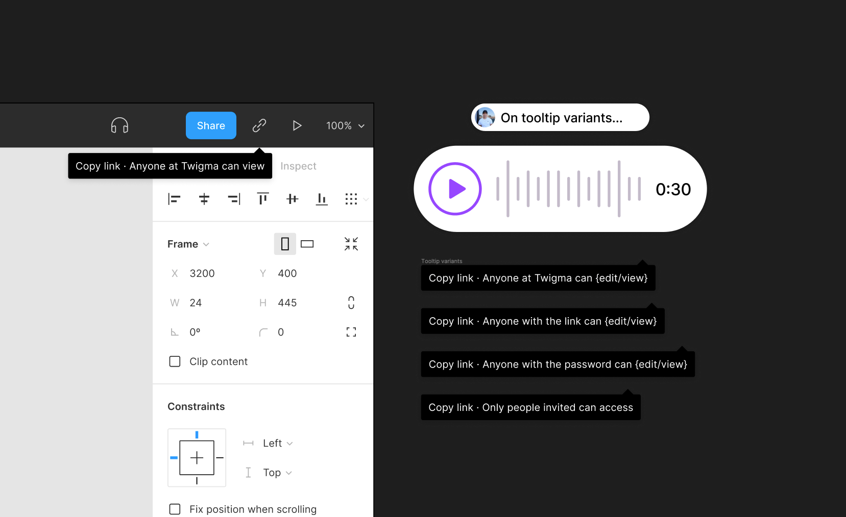

You might also need to provide extra context: multiple string variants, context for an A/B test, localization notes, etc. You could use comments, but I’ve found they aren’t the best for permanently housing critical information.
Instead, add that context directly on the canvas, so it’s always visible. Depending on the stage of the project, you can use one of two methods.
(Quick disclaimer: Designers often provide their own context for handoff, like paddings, color details, etc. If you see notes already on the canvas, chat with your designer about how you should add yours.)
1. Create annotations
An annotation is really just a blob of text that provides additional detail, and can take any form you want it to. It could be bright pink text, a sticky note you copied over from FigJam, etc.—anything that draws attention, and is clearly attached to a specific design element.
A text box says "Truncation + localization," and it points to a phrase that says, "Copied 4 frames over to {%file.name}.A text box says "Truncation + localization," and it points to a phrase that says, "Copied 4 frames over to {%file.name}.

1. Voice memo (by Figma)
An image of the Figma canvas on the lefthand side, and an audio player on the righthand side.An image of the Figma canvas on the lefthand side, and an audio player on the righthand side.
Have you ever spent 30+ minutes writing a comment to explain a bit of copy? Well, now you can skip the scribing and record a message instead. Just hit record, talk your talk, add a title, and leave it wherever you want your teammates to find it.
We’ve been using this internally for a few months now, and I’ve shifted most of my complex notes and context over to voice memos. It saves a ton of time, and I can more easily communicate the thoughts behind my work. (I’ve also started leaving voice memos for myself, which may or may not be a sign that I’m losing my mind. Stay tuned!)

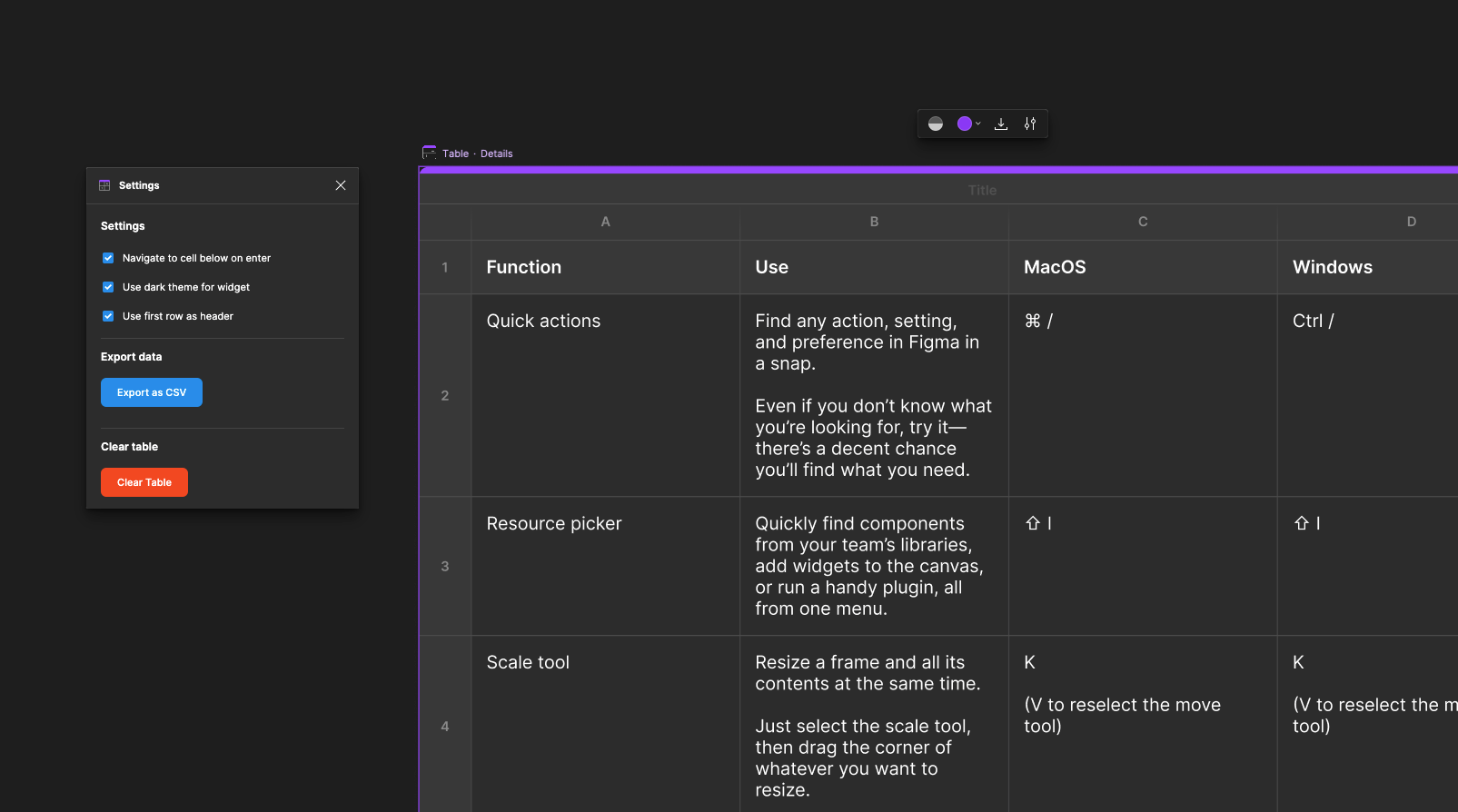

3. Table (by Gavin McFarland)
A table  about keyboard shortcuts with four columns: Function, Use MacOS, Windows.A table  about keyboard shortcuts with four columns: Function, Use MacOS, Windows.
This nifty widget lets you create a flexible, text-friendly table. Start from scratch, or import a CSV or Google Sheets file. You can also export everything to CSV, making it easy to throw together a quick copy doc in your tool of choice.
You’ll find even more functionality by clicking on each row/column header, like sorting data, changing cell sizes, and adding new rows and columns.
