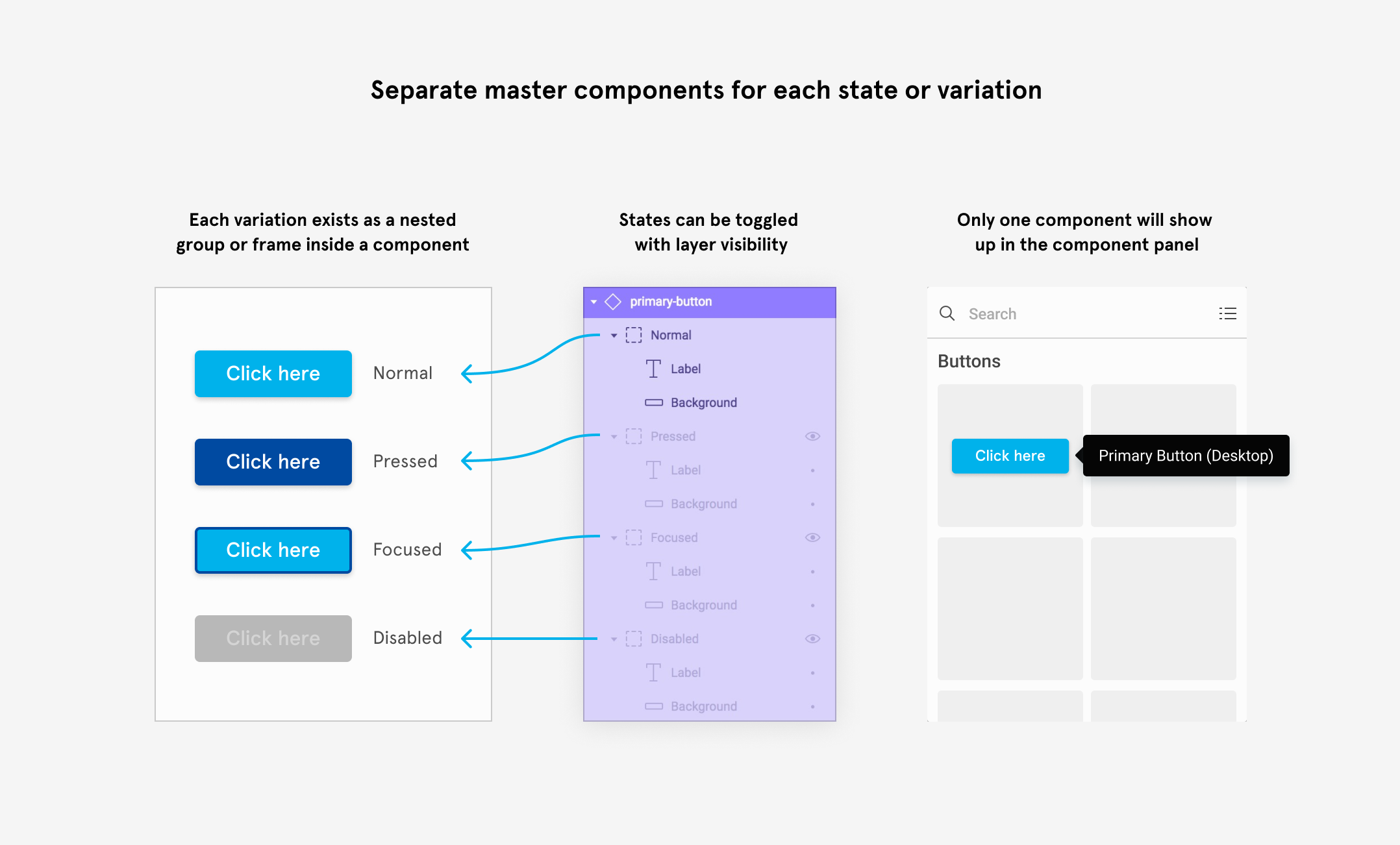

Nesting states and variations in a single component
When you place an instance of a component into your design, Figma gives you access to its layers in the layers panel. This enables you to view and expand each instance in the layers panel. You may consider nesting elements in your component which users can turn on (by toggling the layer visibility) when needed; you could even nest every state within a single component. This method does have some benefits, but also a few drawbacks.
Benefits: There is a single Figma component to share with users. This means one component to maintain, one component for designers to use, and only one to find in the components panel and instance menus.
Drawbacks: This method can make it more difficult for designers for discover the different states within the layer stack of each component. Switching between them can be more cumbersome since designers must know to toggle the appropriate layers within the component. These states are not always immediately apparent unless designers expand the component in the layers panel. This method can also result in a lot of repeated layers within your component. For example, a button comprised of a text box and a rectangle may need to repeat those layers for every state—when users override the text, and later want to show a different variation/state, the designer will need to re-input the override. This use case is handled much smoother with the following approach.

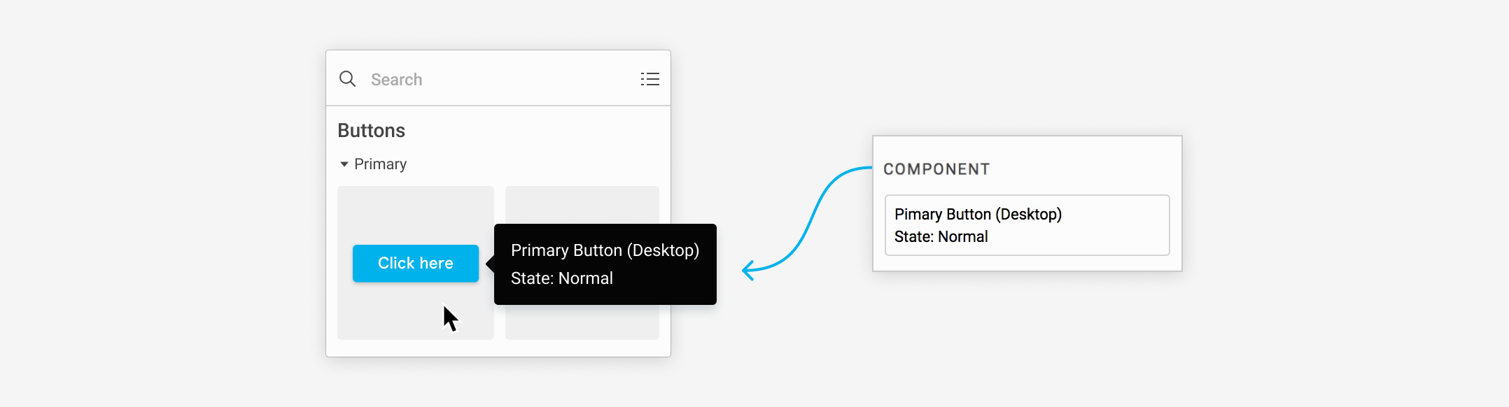

Descriptions
You can add a description to each main component in the properties sidebar. These descriptions show up as tool tips on hover in the components panel. This is also a good place to include info about their intended usage to help users pick the right components.

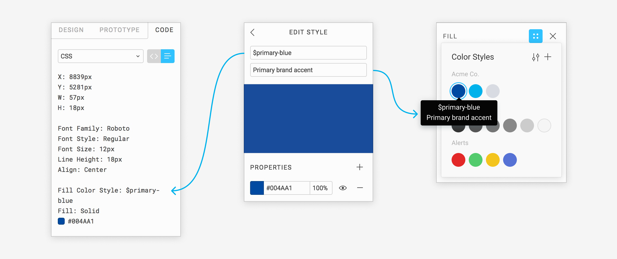

Style tips
Style names: Style names are critical for alignment with predefined properties in your design system. You can also use prefixes separated by a forward slash in the names to group styles in the style picker (note: you can only add one level of hierarchy). For example, if you add "Alerts/" before several styles, they will all appear together under the subheading "Alerts". You might use these prefixes to:
- group colors by hue
- group colors by theme or type
- group accessible colors together
- group type styles by font family or size
- group grid styles by viewport size
Style descriptions: Add descriptions to your styles—these will appear in tooltips in much the same way they do for components. The descriptions can help clarify their intended usage by surfacing additional information to help designers select the right style.
Note: when developers are inspecting your designs, in the code panel, style names will show up as comments in CSS mode and as a line item in table view. The names of color, type, and effect styles will be displayed in addition to their attributes.

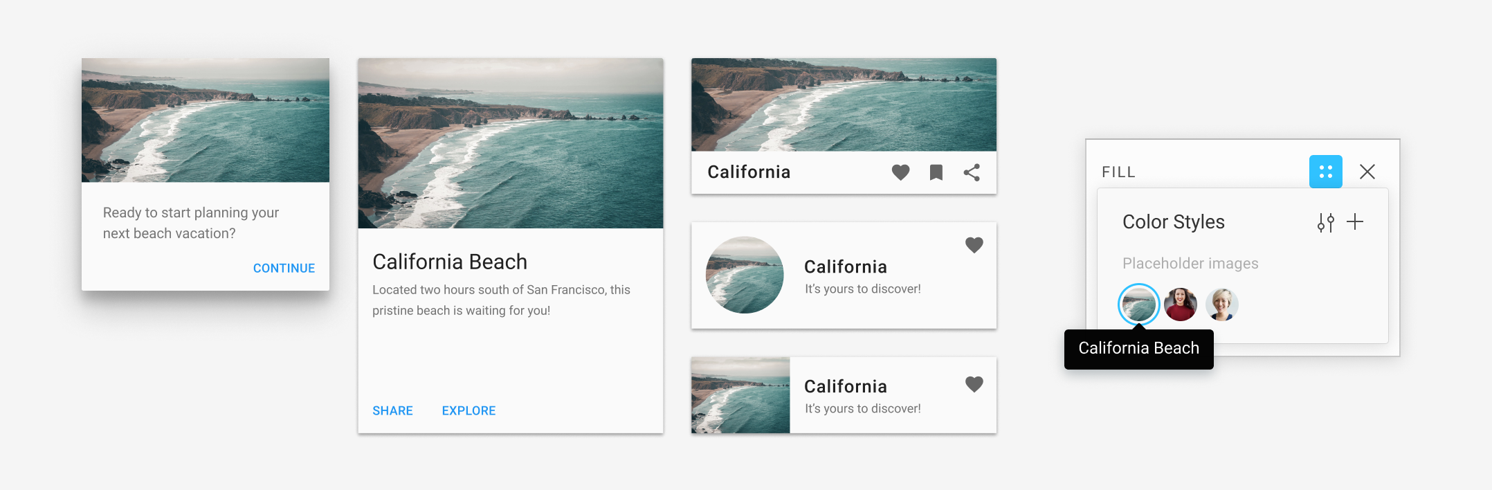

Image fills for Placeholder images: You can create styles for image fills. Lets say you have some user avatars, or placeholder photos you commonly use. You may not know what shape, aspect ratio, or size they will need to be applied to. By creating image fills, you can easily apply them to any shape.

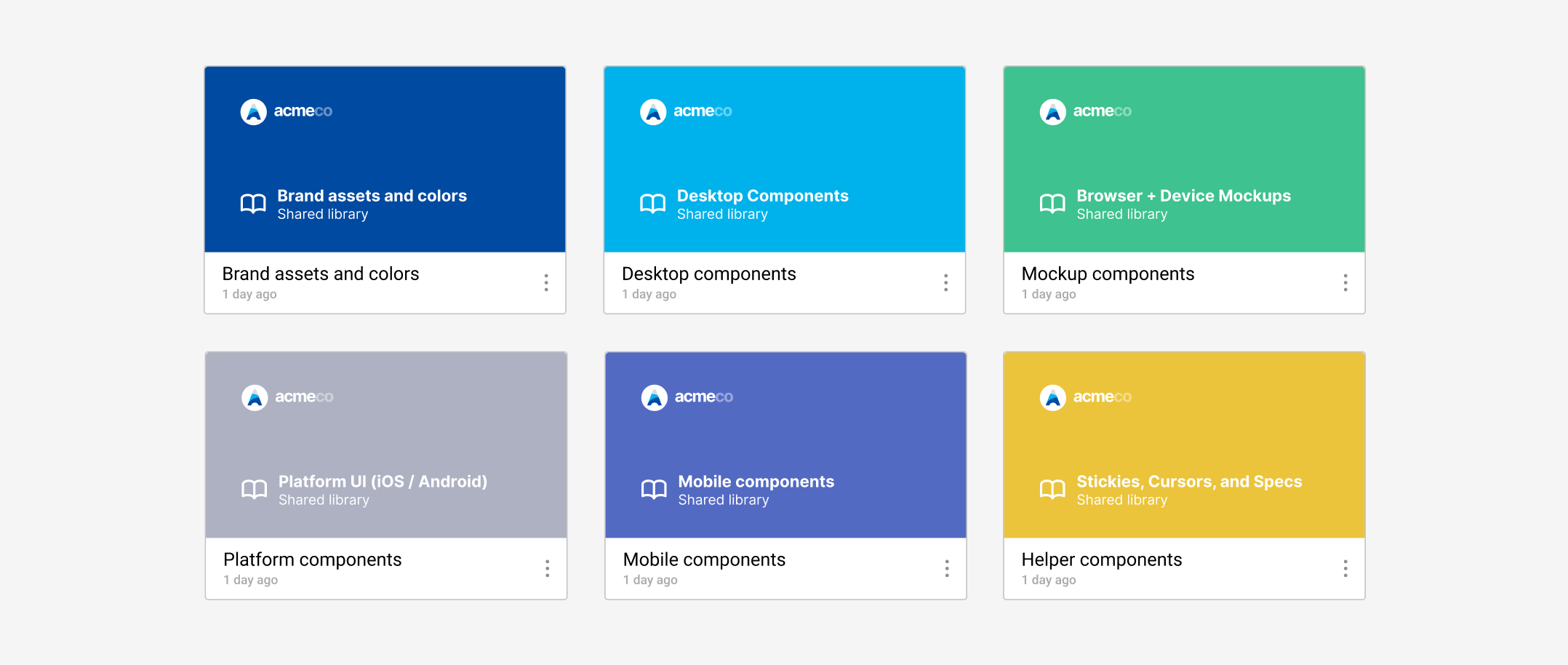

Organizing and creating libraries
To create your first library, publish any Figma document from the Team Library modal. All of the main components and styles in this document will then become available to use in other documents. As you scale design across products or teams, especially in larger organizations, you'll want to figure out the best way to organize and distribute them for everyone to use. How many libraries should you create? How do I organize my components? Remember, the designers consuming these libraries are your end users.
We often get asked if teams should share everything from a single library or use multiple libraries. Of course the answer is, it depends! Let's look at some of the factors to consider.
Everything in one big library
Some teams, particularly smaller ones, will often create a single library to house all of their components and styles for the sake of simplicity. This approach has some benefits but a few big drawbacks as you scale.
Benefits: There is only one library for users to enable that has everything they need. There is never any confusion as to where particular components live. This also means there is only one library to maintain.
Drawbacks: For larger organizations with a lot of components and styles required to support many different platforms and products, this library can grow very quickly. If users only need a small selection of those components, they'll still have to sift through a lot of similar components they never need to use.
Separate libraries
Many teams, especially medium-large teams, often decide the best approach is to break up their components into multiple libraries. This tends to scale much better.
Benefits: By separating components/styles into different documents/libraries, only the required libraries can be enabled for the right subset of users or teams. For example, let's say you have dedicated teams working on only mobile products. Those working on mobile may never have to consume assets designed for desktop. By splitting these into separate documents, you can publish them to separate libraries. Then, designers will only need to enable the applicable library for them, which saves them from having to sift through components they don't need to use.
Drawbacks: For those responsible for maintaining and publishing the libraries, there will be more of them to manage.
Optimizing for success: Libraries can be enabled by default for Pro teams, or across all teams in the entire company in Figma Organization. To learn more about how you might approach this, be sure to read our post on structuring teams.
