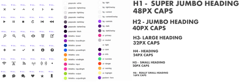

On the Atomic level, text styles and colors were defined using Figma Styles.
A set of icons (customized from Modern Pictograms) was imported and converted to components.
We drew some of the swatch names from Bootstrap. Knowing that colors would be changed in themes, we wanted to use semantic naming for key UI states, and Bootstrap’s were a familiar base.
We extended Bootstrap’s UI and Grayscale categories of swatch with more detailed brand swatch sets, and specific swatches for backgrounds, overlays, and outlines.

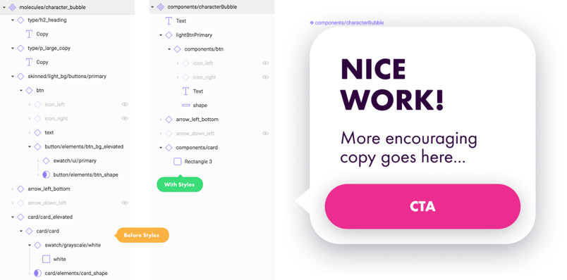

The release of Figma Styles mid way through our process allowed us to drastically simplify the layer structure of our components — this helped a lot with general usability and document performance.

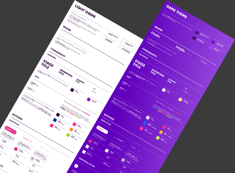

Because it was so simple to mix and match text styles with swatches, we didn’t create extra components for combos of color and styles — we made a style guide for reference, and applied text styles and swatches in templates as needed.
Semantic names for swatches also helps keep patterns and usage clear — for example in a light theme, the “bg — light” swatch is used for background colors, and “ui — dark” is the default for foreground elements. When swatches are used in this way, it’s easier to edit colors design wide in future, and be confident it wont break things.

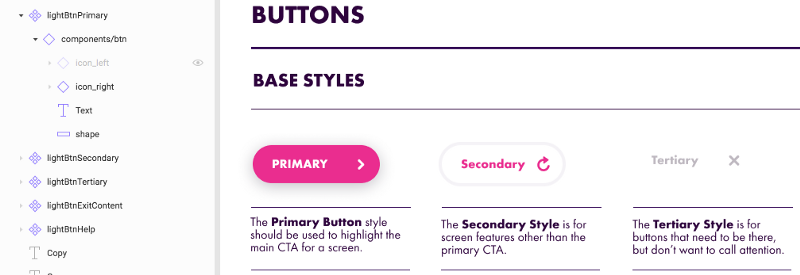

For our main button styles though, we did create nested components.
Some of our button styles had outlines (which still aren’t as easy to centrally manage in Figma), and buttons are of course repeated a lot across the design.
We created Primary, Secondary, and Tertiary styled versions of of our button component, and also called out some other custom buttons that would be repeated a lot in our designs.
