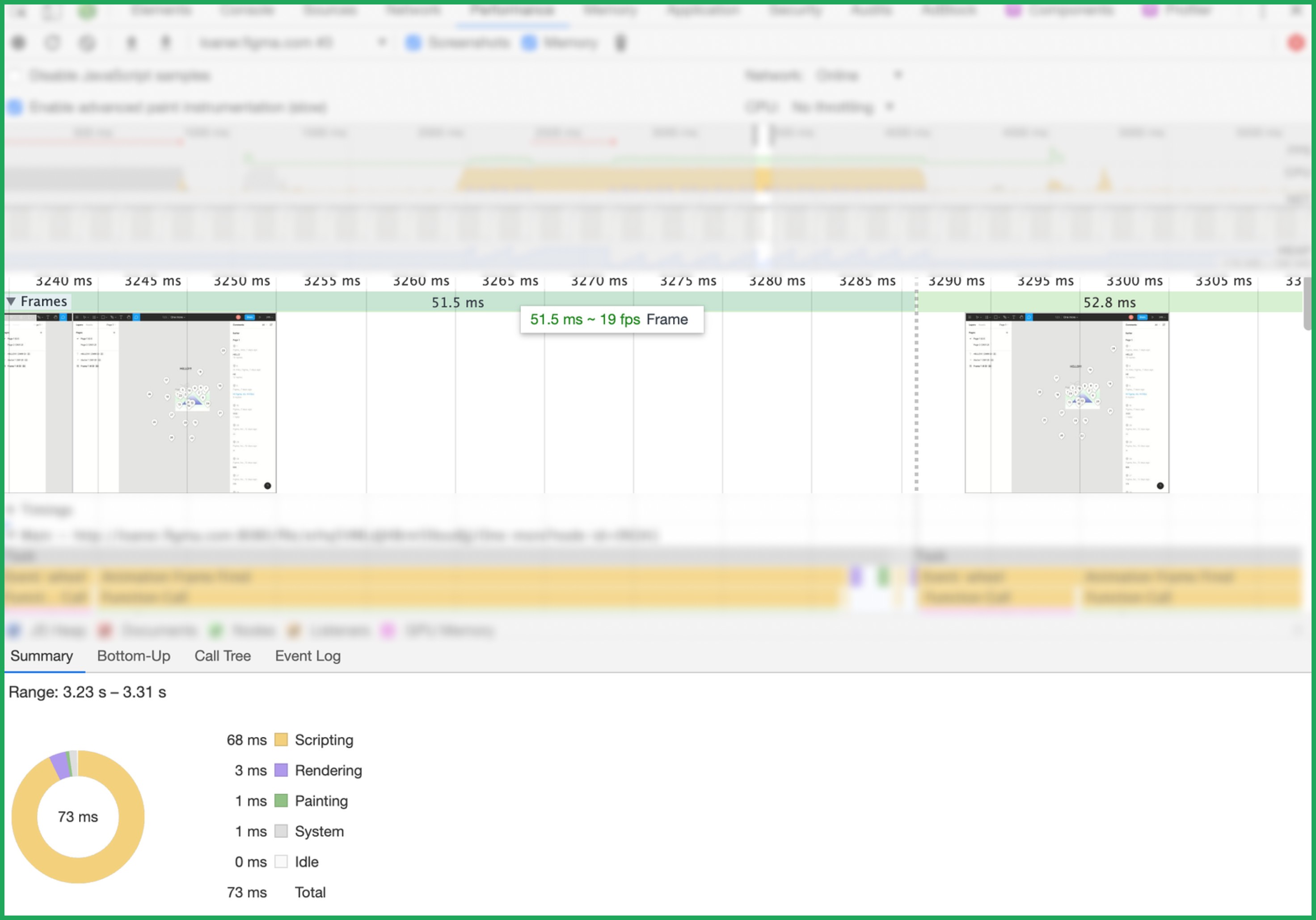

The profile generated from the Chrome performance tools shows that most of the time was spent on JavaScript (JS). About 68ms per frame is spent on JS on a page with 30 comments and only a small port of the computing time per frame is spent on rendering and painting. Scripting refers to JS events and event handlers; rendering and painting have to do with the translation of HTML elements to displayable on-screen elements. It’s promising that most improvement could be done on the JS and React optimization, but we still needed to understand more of what’s happening under the hood of rendering the comment components in React.
Chrome performance tool shows we spent the majority of time on scripting and rendered the comments view at 19fps with 30 comment threads

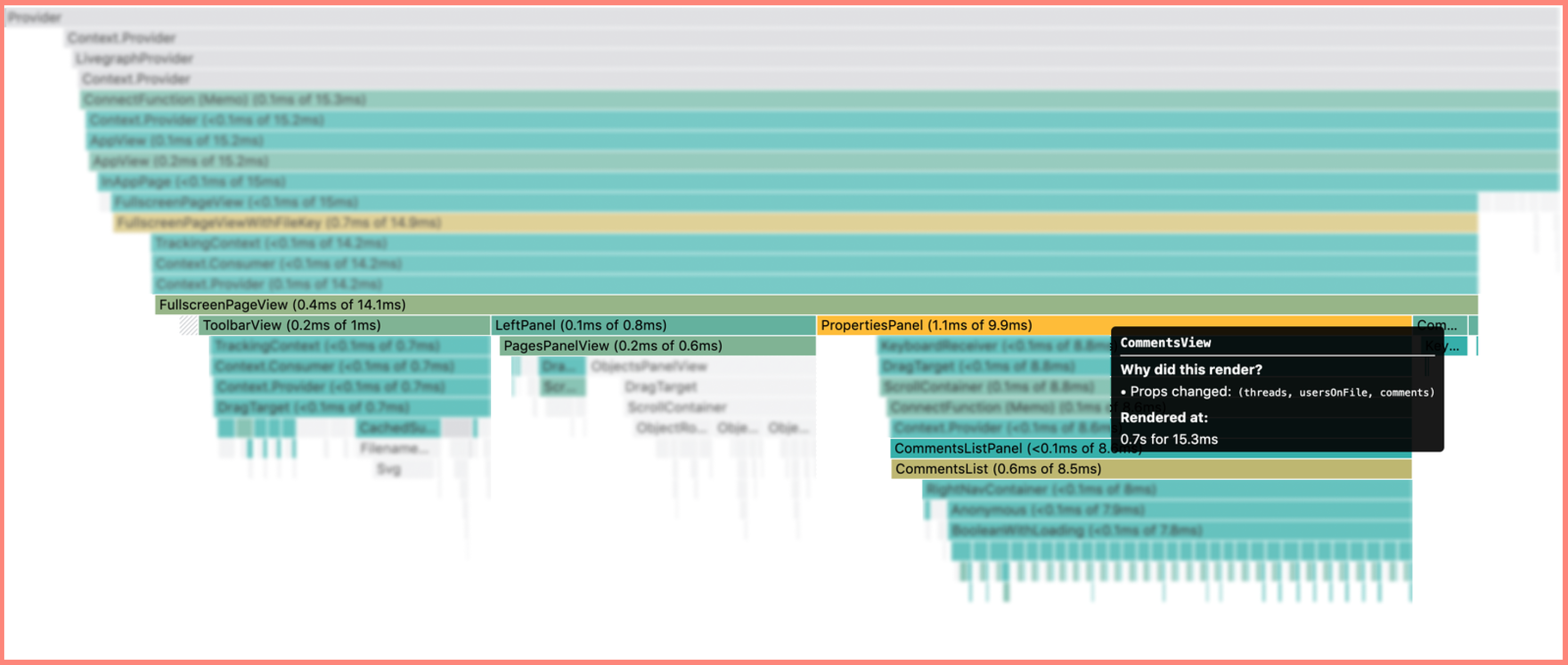

We used React Profiler to pinpoint which components were actually re-rendering. React profile shows that only about 1.8ms is spent rendering the comments view. This re-rendering is necessary because its content is changing. However, from the React Profile, we observed that a lot of time was consumed rendering many fixed position components like the left panel, toolbar view, and properties panel. But intuitively, only the comment should care about the viewport change, not these fixed components. The biggest inefficiency that creeps in as React applications grow is needlessly re-rendering components, which is exactly what we observed. This was a red flag, and we needed to address it.
React Profiler shows the left panel, toolbar view, properties panel, comments list, and comments view re-rendered with every viewport change

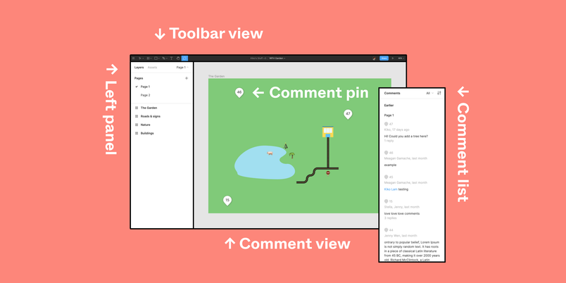

How different components are structured in the Figma editor

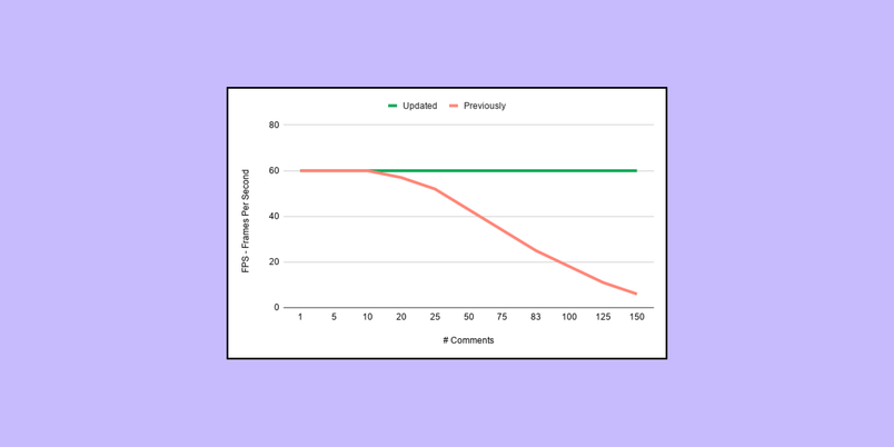

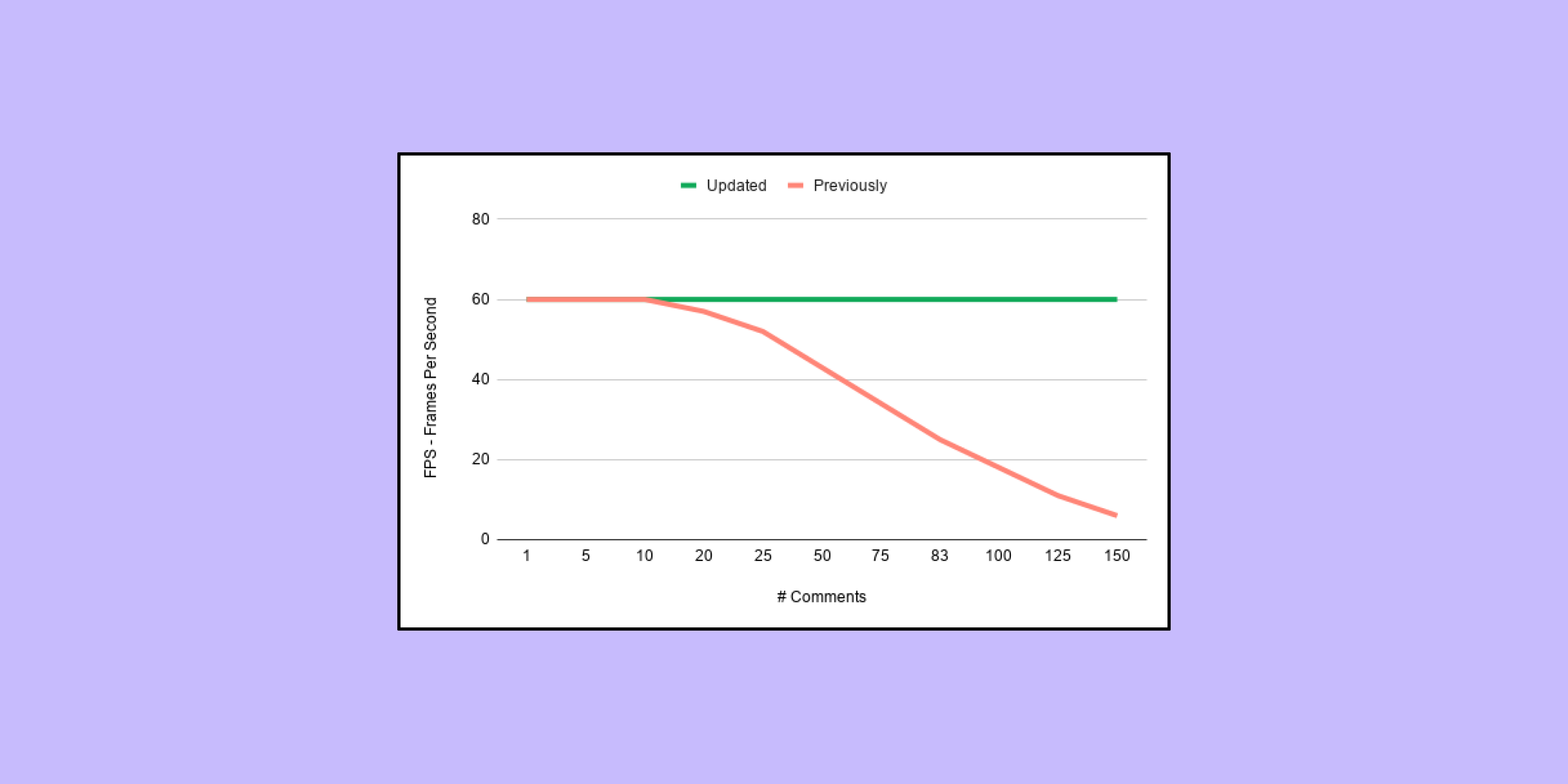

Based on how we scoped the project—achieving 60fps for files with up to 150 comments—it was a success. You can see from the screen recording below that the interaction is much smoother and delivers a better user experience.
Panning is much smoother now
But with performance, the work is never truly done. Moving forward, it'll be an ongoing process of setting new goals and identifying potential bottlenecks.
Now, we maintain 60fps rendering, no matter how many comments there are on a file
