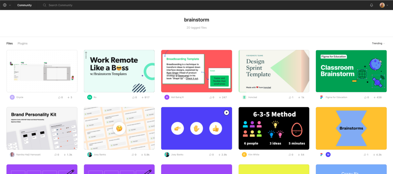

You can either start a brainstorm from scratch or you can browse through the Figma Community and use one of the templates published here, like this one (FigJam Brainstorm Template). We've actually filled out this template so you can see an in-progress brainstorm with a mix of new ideas on how to feature new plans and improve the checkout experience on the Twigma website.

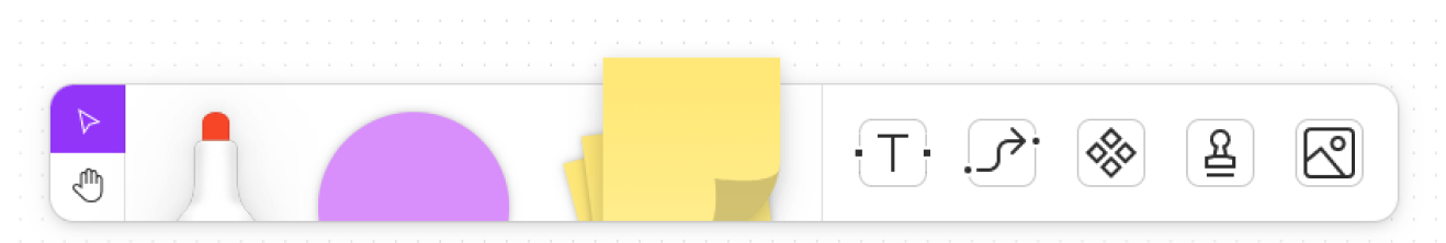

Sticky notes

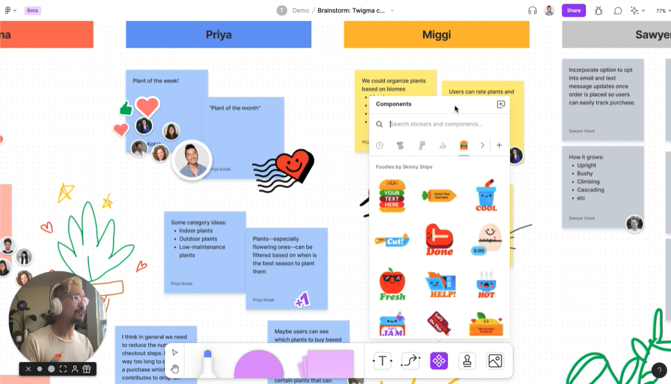

You and your team can start jamming right away by grabbing a sticky note and jotting down your ideas. The way you add a sticky note in the file is by selecting it from the toolbar or typing "S" and clicking anywhere on the screen. Once it's added to the file, you can change the color and/or you can add text. I'll add my idea “plant of the week” and by default sticky notes include the authors so that you can easily follow up with folks about their ideas. Names can be hidden if preferred by using this authorship toggle and, let's say you're brainstorming and you're on a roll and you want to add a bunch of ideas, you can click these buttons: the plus button here to add a new sticky note or use the command "⌘ + enter" shortcut to add a bunch of stickies really quickly.

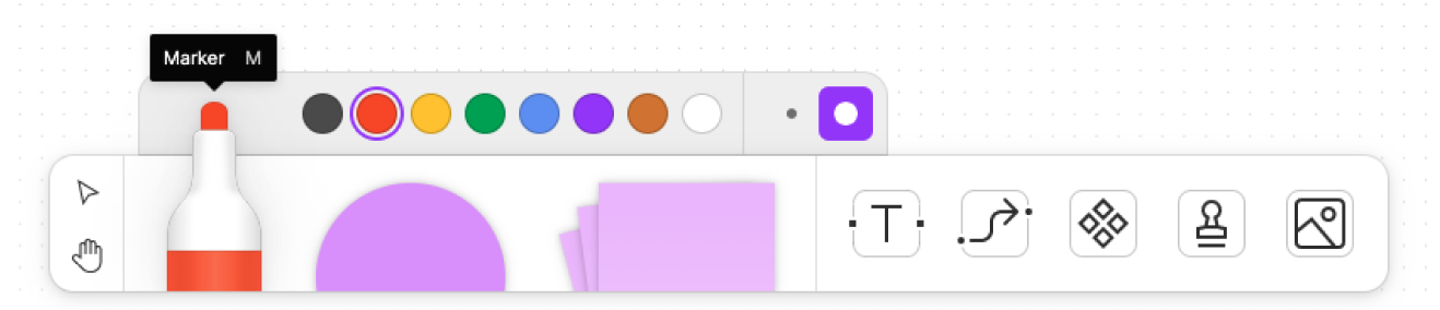

Marker
I'll be going over some of the cool tools at the bottom of the screen here so the first step is the marker. You can access it by pressing "M" or clicking below. You can change the width of the pen and the color and I really like using this to make quick sketches like you'll see up here. Or to annotate ideas and i'm just going to draw an arrow pointing to mine.

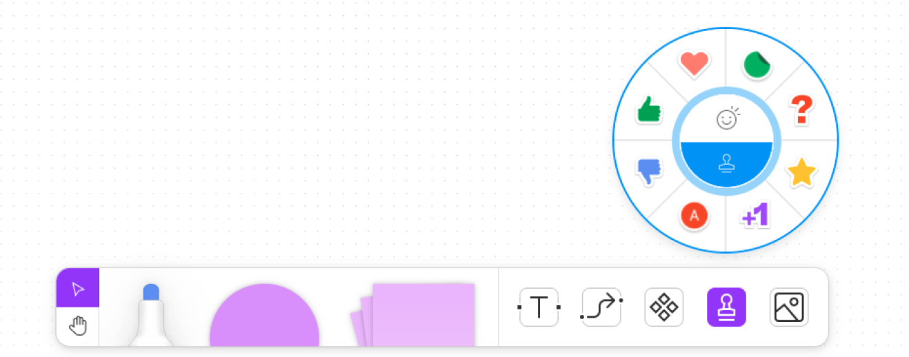

Stamps
When you're brainstorming and you want to vote and get people's ideas of what they think is best, you can do so with the stamp wheel. So, if I click at the bottom of the screen here, I can access the stamp wheel or press "E" and I can select a different range of stamps (from a heart to a plus one button or I can even use my own face to vote). Oh, someone has the same idea as me, so I love this idea clearly, and I want to emphasize that I really like it. If I click and hold down the stamp, it will actually get larger to really emphasize how much I like this idea.

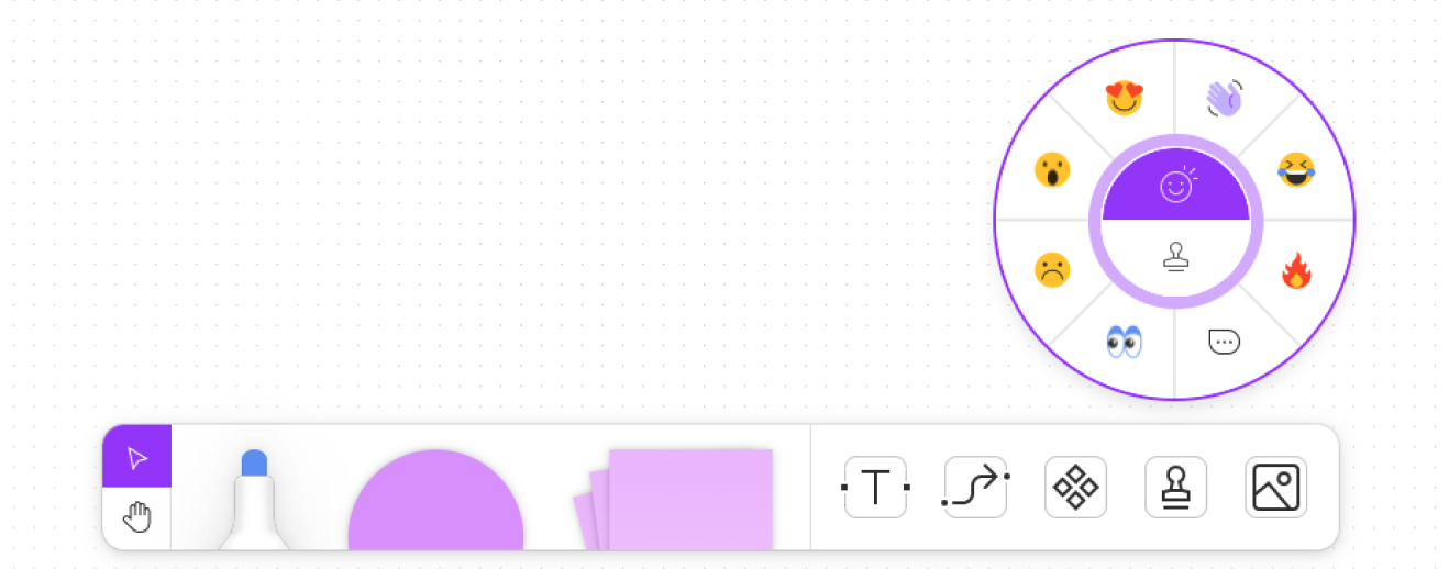

Emojis reactions
Another way that you can react to people's ideas is through the emoji reaction wheel. You can access it by clicking the toggle here or accessing it by pressing "E" twice. This is really helpful if someone is presenting and you want to just show your love for it. Let's say someone has a great idea and they're talking about it on a call: I can show that I love it.

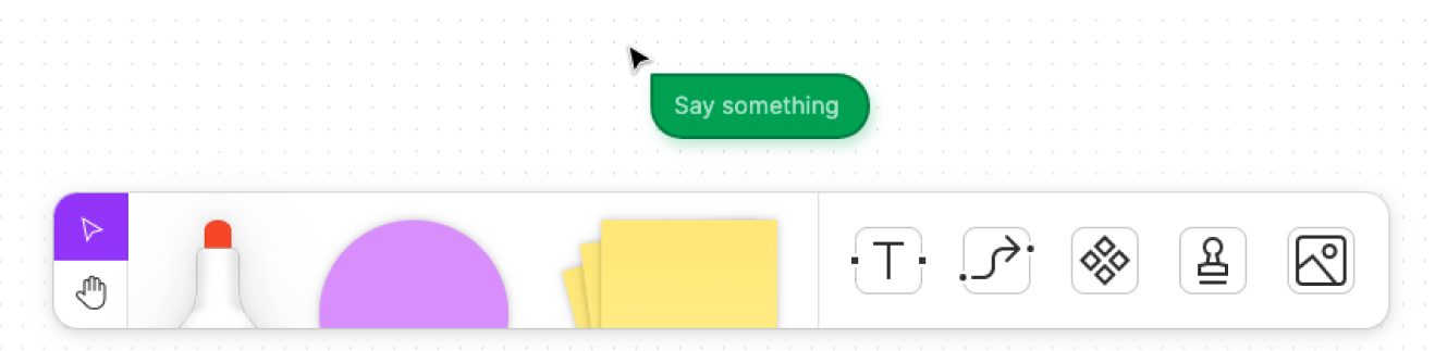

Cursor chat
And next is actually my favorite feature which is the cursor chat feature so I can access it by typing forward slash or by clicking here on the wheel. I find this to be really helpful when I'm in a file with someone and I don't want to jump on a call, but I want to say “hi” or, if we are in a workshop and I have a question, instead of interrupting while someone's presenting I can just type it out here and someone else can answer me, or if the facilitator sees it, they can take a pause and answer my question. This is a pretty ephemeral, so it'll disappear in a few seconds (this will disappear in a couple of seconds).

You can also use components in FigJam. If you want to keep your libraries open (let's open it first, so click down here), you can actually drag and pin it to either side of your board. FigJam has created some default components to help get you started (we've worked with a couple of cool artists here). I love using this start component to really get people's attention and so they get an idea of where they should actually be starting. You can add labels and indicate the status of a project: “we are done” or I can even ask for my team's feedback.
