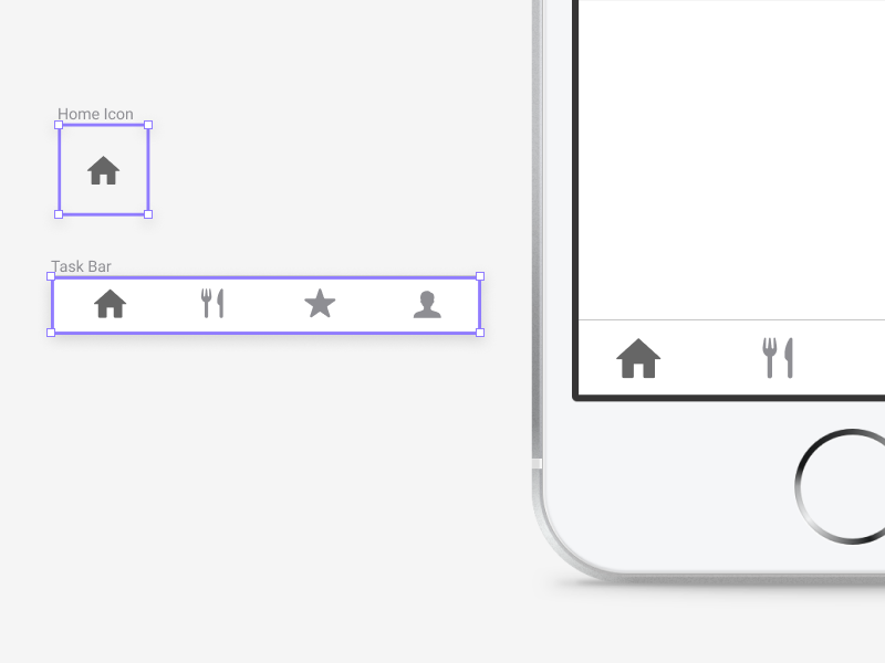

Max two level deep component nesting
Working with components and nesting them feels pretty powerful at first. By building components out at an atomic level (like icons) and assembling them into larger components (like status bars), you give yourself the flexibility to change one small piece of your system and watch it reflect in every part of your design. For those unfamiliar with the practice, here’s a blog post and a tutorial video that go into more detail.
Going two levels deep in component nesting provides the best balance of usability and possibility.
But as soon as you go more than a few layers deep — for example, let’s say you nest an icon component inside a status bar component, which itself is nested inside a home screen component — your process can get really confusing. With great power comes great responsibility, and I’ve found that going about two levels deep in component nesting provides the best balance of usability and possibility. It’s a crucial guideline that keeps our design system manageable.

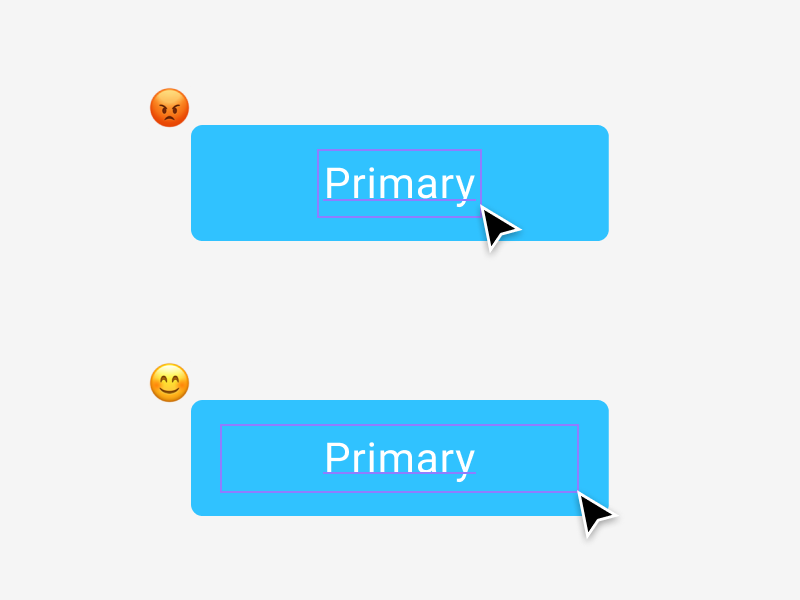

Make it easier to select layers (especially with text)
To design quickly, you need techniques for manipulating layers and components. They often have invisible bounding boxes around them that can be tricky to nail (much like the ‘hit box’ targets in FPS games). For example, let’s say you create a standard component, with only a text label in it. By default, when you create a text layer in Figma the handles (dashed lines) surrounding it are small, wrapping the text nearly 1:1.
At Kiwi.com, we’ve gotten in the habit of automatically stretching those handles to the borders of the component. Then, we can double click almost anywhere in the component to edit the label.
You have to take a slightly different tact when you have two labels in a component. If you stretch both of these labels to the edges, they will overlap (and the handy ‘stretch to click’ technique no longer works). In this case, make one of the labels a bit smaller (I usually make it half the size), and push it to the top of the layer list in the left-hand panel. Then, you have a convenient way to double click and edit both layers, either by clicking the large one on the canvas itself, or by clicking smaller one in the layers panel.

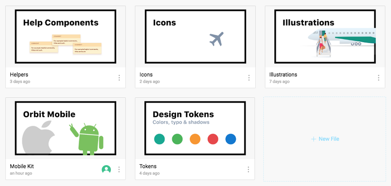

Project cover
It might seem like a little thing, but navigating through Figma can be a pain when you have lots of files and projects. File titles work, but it is hard to scan them fast. That is why we use cover images.
Project file structure
We stick with one file per project or flow (we have files for things like place picker, date picker, search and similar). We chose this solution because we found that having many user flows in one file makes it slow to load.
One drawback — You cannot connect two files and create a prototype from them in Figma. So, with flows separated between files, we can’t test certain user behavior (like going from the booking flow to their profile information).

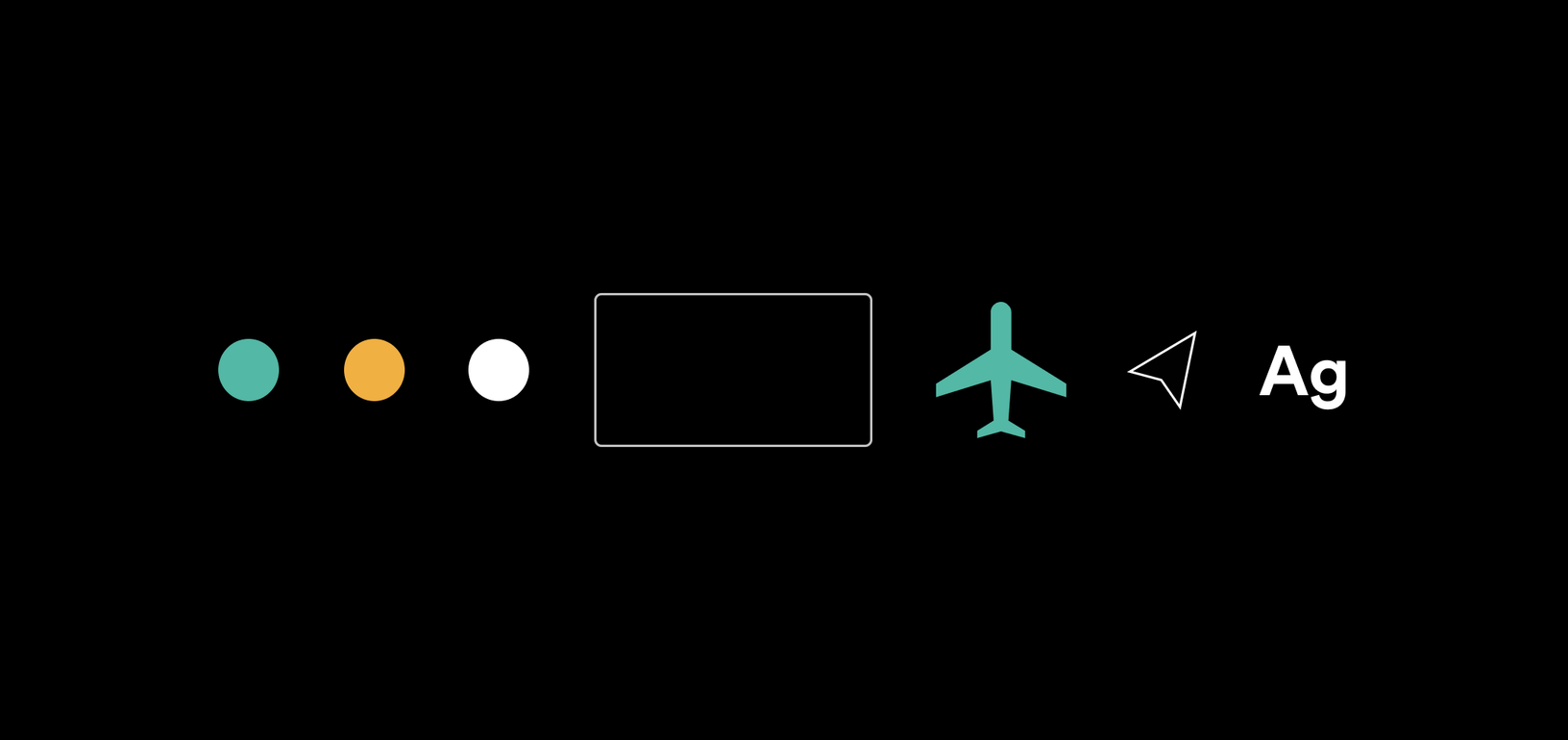

Tokens
This file is rarely touched. It contains the most atomic components of the entire design system. The file has three pages: colors, typography, and shadows. Basically everything you can define in Figma Libraries, except for components.
Typography is the same as colors. We’ve already defined everything we need in our design system (it is missing some FE font style definitions), and thus is rarely touched. The typography defined above seems rather simple, but when combined with other shared styles, it’s everything we need on mobile.
Shadows are something we’re still experimenting with, but so far we’ve defined 4 elevation levels, and this seems to work well for us.
