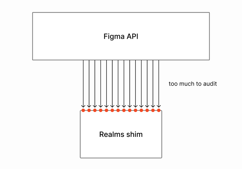

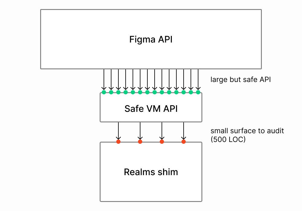

We decided to implement this alternative after a security vulnerability in the Realms shim (which our original approach uses) was privately disclosed to us. The security vulnerability was promptly fixed by the Realms shim team before the vulnerability was made public and we have no evidence it was ever exploited. Read more about the vulnerability and our approach to fixing it here

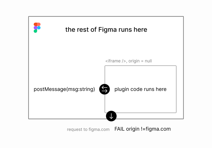

The <iframe> is not your everyday HTML tag. To understand why <iframe>s are secure, it’s necessary to think about what properties they need to guarantee. An <iframe> is typically used to embed one website into another website. For example, in the screenshot below, you can see that yelp.com is embedding google.com/maps to provide map functionality.
Here, you wouldn’t want Yelp to be able to read what’s inside a Google website just by virtue of embedding it. There could be private user information in there. Similarly, you wouldn’t want Google to be able to read what’s inside a Yelp website just by virtue of having been embedded.
This means communication to and from the <iframe> is heavily restricted by browsers. When an <iframe> has a different origin than its container (e.g. yelp.com v.s. google.com), they are completely isolated. Then, the only way to communicate with the <iframe> is via message-passing. These messages are, for all intents and purposes, plain strings. Upon receipt, each website is free to take action on those message, or ignore them.
They’re so isolated, in fact, that the HTML spec allow browsers to implement <iframe>s as separate processes, if they chose to.
Now that we know how <iframe>s work, we can implement plugins by creating a new <iframe> every time a plugin runs, and sticking the plugin’s code inside the <iframe>. The plugin can do anything it wants inside the <iframe>. However, it won’t be able to interact with Figma documents except through explicit, whitelisted messages. The <iframe> is also a given a null origin, which means that any attempt to make a request to figma.com will be denied by the browser’s cross-origin resource sharing policies.
Effectively, the <iframe> acts as a sandbox for the plugin. Furthermore, the security properties of the sandbox are guaranteed by browser vendors, who have spent years searching for and fixing any vulnerability in the sandbox.

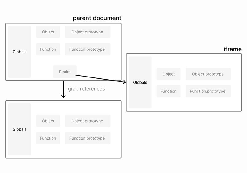

Well, almost. It’s still possible to access certain globals via expressions such as ({}).constructor. Furthermore, the sandbox does need access to some globals. For example, Object is a global, often used in legitimate JavaScript code (e.g. Object.keys).
To give plugins access to these globals without messing up the window, the Realms sandbox instantiates a new copy of all these globals by creating a same-origin iframe. This iframe is not used as a sandbox the way we did in our first attempt. Same-origin iframes are not subject to CORS restrictions.
Instead, when an <iframe> is created in the same origin as the parent document:
  1. It comes with a separate copy of all the globals, e.g. Object.prototype
  2. These globals can be accessed from the parent document.
These globals are put into the Proxy object’s whitelist, so that the plugin has access to them. Finally, this new <iframe> comes with a new copy of the eval function that differs from the existing one in an important way: even built-in values that are only accessible by syntax such as ({}).constructor will also resolve to a copy from the iframe.

In general, the sandbox should never have direct access to an object created outside the sandbox as it could get access to global scope. It’s also important that the API is careful about manipulating an object from inside the sandbox, as it risks getting mixed with objects outside the sandbox.
This poses a problem. While it is possible to build a secure API, it is not tenable to have our developers worry about subtle object origin semantics every time they want to add a new function to the API. So how can we fix that?
An API for an interpreter
The problem is that building the Figma API directly on top of Realms makes it so that each API endpoint needs to be audited, including its input and output values. The surface area created is too large.
Despite the fact that code inside the Realms sandbox runs using the same JavaScript engine (and gives us convenient tooling benefits), it still helps to pretend that we live under the restrictions of the WebAssembly approach.
Consider the Duktape, the JavaScript interpreter compiled to WebAssembly from Attempt #2. It’s not possible for main thread JavaScript code to directly hold a reference to an object inside the sandbox. After all, inside the sandbox, WebAssembly manages its own heap and all JavaScript objects are just segments in this heap. In fact, Duktape might not even implement JavaScript objects using the same memory representation as the browser engine!
As a result, implementing an API for a Duktape would only be possible via low-level operations such as copying integers and strings in and out of the virtual machine. It would be possible to hold a reference to an object or function inside the interpreter, but only as an opaque handle.
Such an interface would look like this:

This low-level interface can be implemented equally well with the Realms sandbox. Such an implementation is a relatively small amount of code (~500 LOC in our case). This small amount of code then needs to be audited carefully. However, once that is done, future APIs can be built on top of this interface without worrying about sandbox-related security issues. In literature, this is called the membrane pattern.
Essentially, this treats both the JavaScript interpreter and the Realms sandbox as “some separate environment in which JavaScript runs."
There’s one more key aspect of creating a low-level abstraction over the sandbox. While we are confident about the security of Realms, it never hurts to be extra careful when it comes to security. We recognize the possibility that Realms could have an undiscovered vulnerability that will one day turn into an issue we need to deal with. But this is why we had a few paragraphs talking about compiling an interpreter that we don’t even use. Because the API is implemented with an interface whose implementation can be interchanged, using an interpreter remains a valid backup plan that we could use without reimplementing any APIs or breaking any existing plugins.

We solve this problem by reintroducing, yet again, the null-origin <iframe>. Plugins can create an <iframe> (which we show inside the Figma editor as a modal) and put any arbitrary HTML and Javascript in it.
The difference with our original attempt at using <iframe>s is that now, the plugin is made of two components:
  • The part that can access the Figma document and runs on the main thread, inside a Realms sandbox.
  • The part that can access browser APIs and runs inside an <iframe>.
These two parts of can communicate with each other via message passing. This architecture makes using browser APIs a little more tedious than if we could run both parts in the same environment. However, it is the best we are able to do given current browser technologies, and it has not prevented developers from creating amazing plugins in the two months since we opened the beta.
