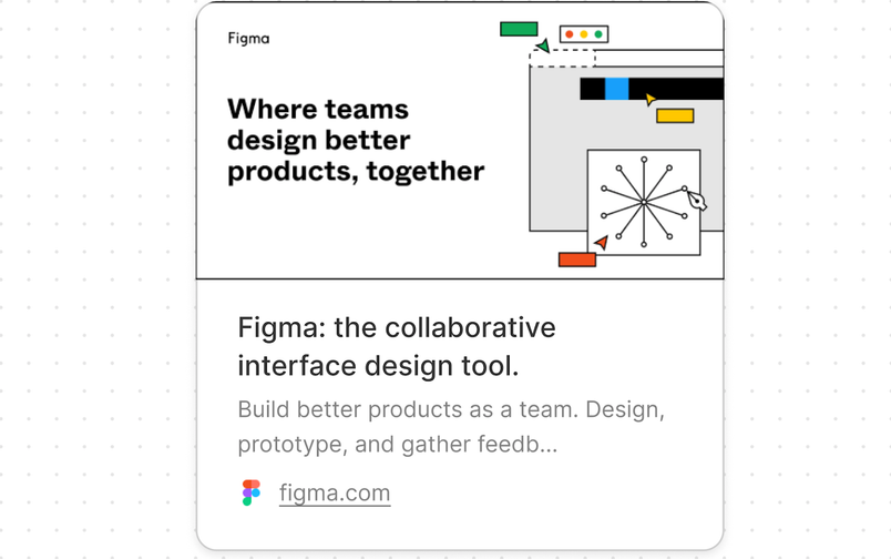

Last year, the FigJam team built rich previews for links. A user can paste a link into FigJam and instead of only seeing link text like https://figma.com they see a tile that includes the icon, description, and other metadata from the linked site.

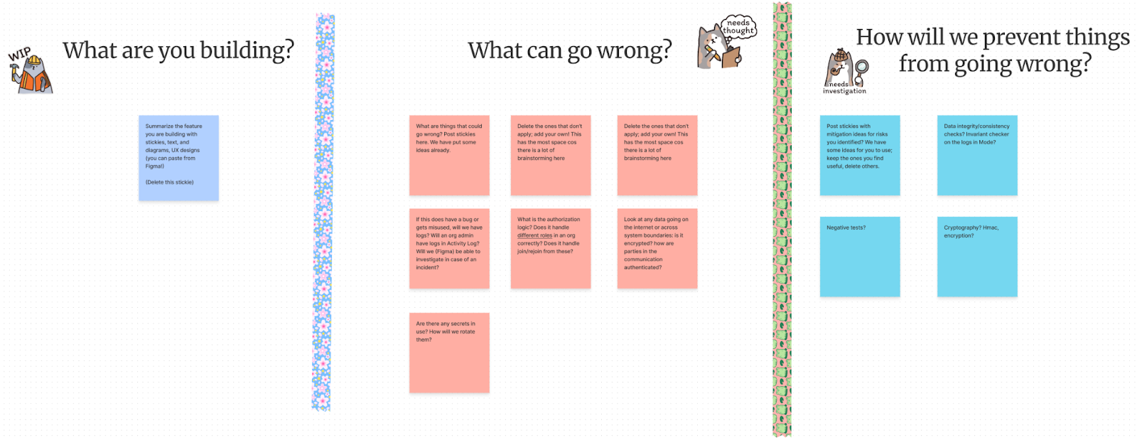

We take an integrated approach to make sure any new features like rich preview links are secure. That includes periodically reviewing upcoming new features and workflows to identify potential security risks and reaching out to the appropriate teams to better understand and help them secure their projects. We also host security team office hours three times a week to answer questions and discuss upcoming product launches. Before office hours, we ask Figmates to answer a three-question survey called “ThreatJam,” which lives in a FigJam file:
The questions prompt Figma’s product teams to share information with the security team so we can assess potential risks, from the possibility of compromised vendor components to misconfigured cloud resources. For example, the team that built rich preview links reached out to us for advice on how to fetch the link metadata to include in previews. After seeing their responses to the survey and discussing live at office hours, we identified the potential for malicious users to:
