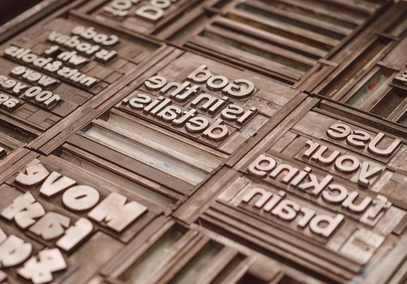

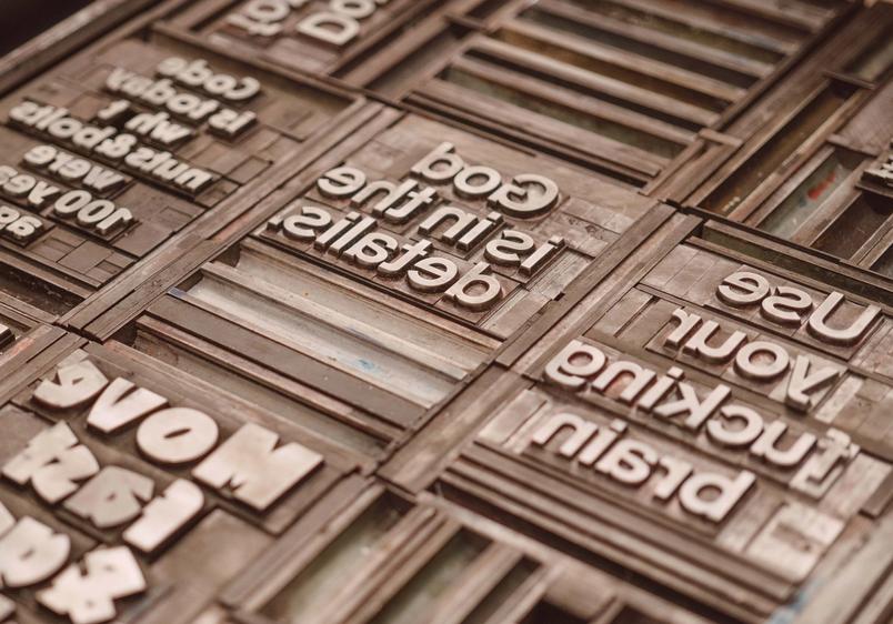

Things were simpler in the days when type was made out of metal. There were two main roles — type designer and typesetter — and their work was constrained by the rules of the physical universe.
It also helped that by late 1800s, the type industry had figured out most of the basics. A life of a typeface would start on paper, with a type designer spending weeks or months sketching all the necessary letterforms. After they were done, the drawings of the typeface were turned into a font: actual physical blocks of lead.
You needed to buy one or more such blocks for each letter. You also needed to buy additional metal blocks for different sizes of text. But font size wasn’t defined as the size of the letters — it was the height of the metal block holding them, expressed in a unit known as point (each point was a 1/72 of an inch, or about 0.4mm). The block height was known, but within it, the type designer could do whatever they wanted: Fonts of the same size could be bigger or smaller, their baseline (the line each letter “sits” on) placed higher or lower, and so on.
When the typeface was finished and the fonts made, the type foundry that employed the designer would sell them to printing shops. Those, in turn, would employ typesetters, whose job was to lay out the metal blocks into words, then sentences, then paragraphs, then pages.
Typesetters could put lines of blocks immediately one after another, in a process called setting type solid, since it resulted in solid, unspaced blocks of lead. Usually, however, they inserted extra narrow strips of metal to space things out, let text breathe, and make it easier for the reader’s eyes to jump from one line to another.
Since the spacing strips were made of lead, the practice of adding that space was called leading (pronounced “ledding”). Here is an example of a 16-point type with 4-point leading, which gives us text with a combined line height of 20pt.
Finding the right amount of leading was its own art. It needed to be different depending on the font sizes and lengths of lines. Even dealing with the same font size and identical amount of leading could make one font look cramped and another floating in space.
It was a relatively simple system, with clearly defined roles and rules. The font came from the type foundry as a monolithic, unchangeable block, and line height could only be added, never removed. Yes, you could order a font with an unusual line height built in, but that was uncommon. (Any such font came with a discouraging name — “bastard type”.) Your job was to lay things down and space them to your heart’s content.

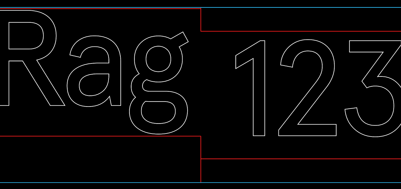

Fonts were no longer solid blocks of lead; instead, they arrived as collections of numbers packed into files. A type designer or type foundry also had to prepare their fonts in different file formats, subject to the requirements of early graphical platforms — Windows, Macintosh, and now-forgotten OS/2. (Plus, the platform’s rendering of fonts was sometimes quirky or buggy, and type foundries had to adjust for that, too.)
Not everything was horrible, of course. Computers gave both type designers and typesetters unprecedented amounts of freedom. Pixels were subject to few of the restrictions of the metal universe — things could overlap at will, or stick out of their once-rigid boxes. As a typesetter, you could add as much leading as you needed without requiring any actual lead. Alternatively, you could remove said leading. Even all of it, if you so desired.
In the physical world, a box needed to have actual minimal dimensions, since leading could only be added. But in digital type, the default line height of a font could be set to a completely arbitrary number – and it often became taller than font size and more comfortable to read (as opposed to setting things solid, which usually felt too tight).

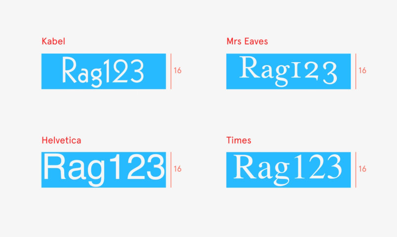

The other change CSS introduced? The 100% line height was redefined as “100% of font size.” Before, a font designer might have given a 16-pixel font a default line height of 20 pixels. But on the web, 100% line height of a 16-pixel font came to be exactly 16 pixels, regardless of what the original designer dictated.
The reason for that change was simple: knowing the default line height of a font required loading that font, which could be really slow on the early internet. Multiplying line height by font size, on the other hand, could be done immediately. “We wanted to do as many calculations as possible without having to load the font,” mentioned Håkon Wium Lie, co-creator of CSS. Line height no longer understood the font inside — luckily, the fonts weren’t required to fit within physical boxes, so that wasn’t that big of a problem.
And so, the same font as before would have a size of 16 pixels — but a line height of 20 pixels would now be expressed as 125% or 1.25, since 16×1.25 gives exactly 20. (The traditional 100% was preserved in one specific instance, as line-height: normal.)

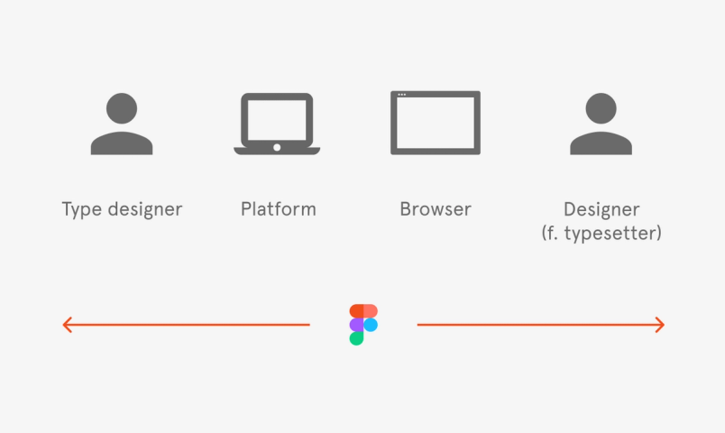

Changes to Figma
This world, with all its line height baggage, isn’t the one we perhaps would’ve chosen to inherit when launching Figma ;·). We didn’t, however, have a choice. And, on top of all the previously mentioned challenges, Figma came with its own unique set:
- people use Figma to design on different platforms
- people use Figma to design for different platforms
- people do all these things while working together (using multiplayer)
- Figma exists in a larger ecosystem and needs to understand and respect it

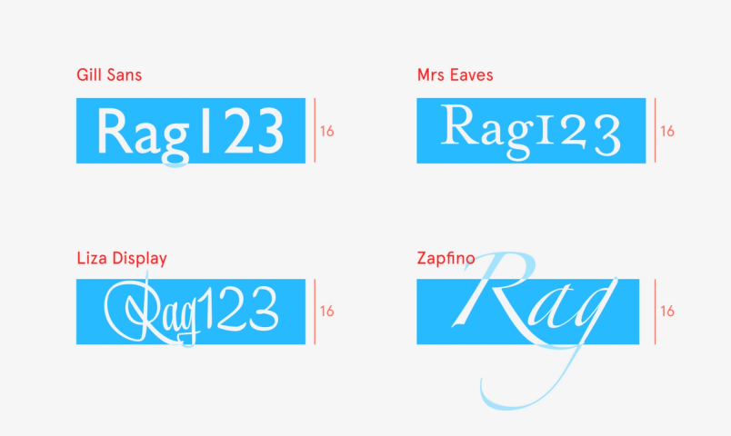

There is no longer one way to think of type…and yet Figma needs to think of type one way. We couldn’t render things differently on different platforms, because that would cause trouble for people collaborating on one file. We wanted to support designing for iOS devices in your Chromebook web browser, or Android apps on your Mac, but we didn’t want a set of toggles to make Figma’s type UI feel like one platform or the other. We needed to create a convenient, powerful UI – but also understand that often the end result of work in Figma lives elsewhere as CSS, or native source code.
Figma originally borrowed from the world of print: line spacing was added below and “100%” meant “font’s default line height.” Over time, however, it became increasingly obvious that this is less and less how people think of or use type. Instead, most expect fonts to behave like the web; our approach to fonts caused trouble in the handoff between design and engineering, and even in designing itself.
We heard from a lot of you that Figma’s approach to text was confusing, so we looked at it more carefully. We observed how people used Figma to design visuals and UIs for all sorts of platforms. We dug into the history of where different line height and typography interpretations came from. We built tools to help ourselves understand how different platforms use text (here is one you can play with that explores line height on different platforms).
And we went through a lot of seedy alleys of typography, places I wouldn’t want you to ever encounter: rogue fonts, ridiculously tall text cursors, selections that overlapped or refused to.
After all the research and conversations, we settled on a particular set of changes to how line height is treated inside Figma. It’s a solution we hope will meet more of your needs and use cases, while not causing any trouble for the less popular ones.

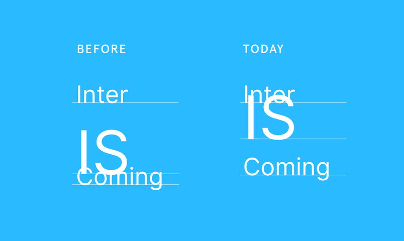

1. Line height distribution

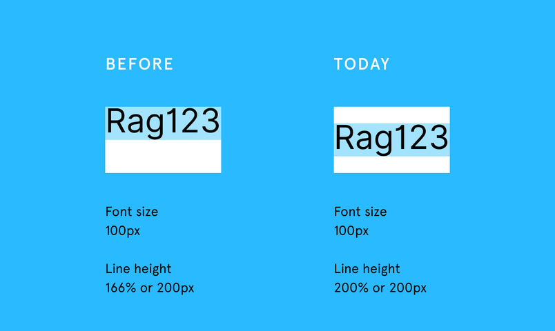

In text boxes, Figma will now distribute line height just like web does. This should help most people with most tasks — not just designing for the web.
2. Treatment of subsequent lines
Every subsequent line will have its leading added above, though. This is different than CSS where the leading would be split above and below, and different than Figma’s prior behavior of putting all the leading below; we believe it’s easier to control text if the extra leading goes in one place, as people often use line height to space lines of text apart.
3. Font size percentage

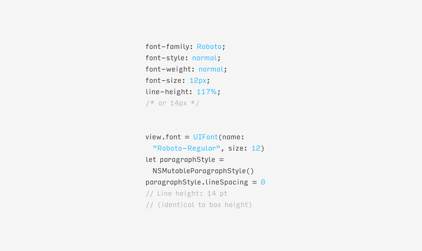

Line height 100% now means “100% of font size” rather than “100% of font’s default line height.” This should make calculations easier, and remain in sync with how most people think of this value.
Text boxes also start with automatic line height. When you switch between the fonts, we will adjust the line height to match the font’s default line height. That will make it easier to explore different fonts and have the text feel great either way. We won’t do this, of course, if you specify line height in pixels or as percents.
4. Line heights in pixels

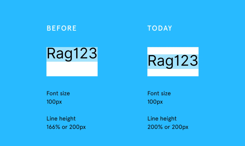

Speaking of pixels…from now on, whenever you say “I want my line height to be 20 pixels,” we will be more forceful in respecting that — even when the web wouldn’t be (line-height in CSS is really min-line-height). We watched people use specific line height values for aligning things, and we want to respect that.
5. 🤗❤️✏️

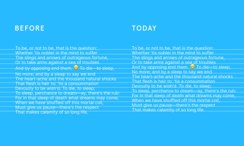

We’ve also observed people (and ourselves) getting annoyed when inserting emoji stretches the line height and destroys the rhythm of text. Now, if you sprinkle your text with emoji, we’ll no longer expand the line box.

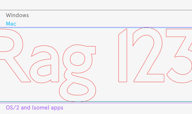

Previously, we interpreted font files according to one method. We learned that this method meant some fonts were drawn a little bit higher than people expected. This is now fixed.

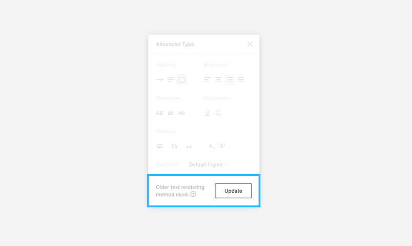

We also want to be respectful of the many designs you might have already made in Figma. You will only get any of the above updates to text rendering if you create a new text box — but we won’t automatically upgrade any of your previous text boxes, because that could shift things up and down.
You can update your previous text boxes at your own pace (either one by one, or by selecting all items on your canvas, and doing it en masse), and any of the changes will be reversible.
