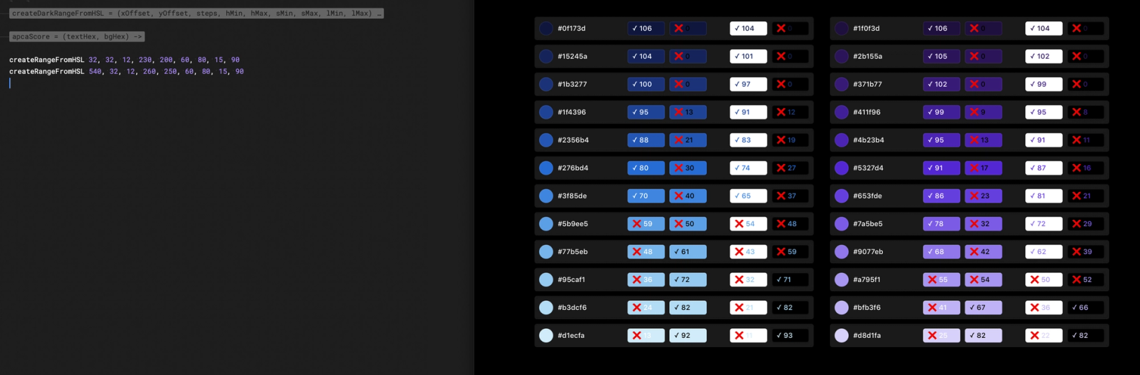

Once we defined the schema, Ryhan began to iterate on color definitions for each semantic token for dark mode and a new, improved-contrast version of light mode. In parallel, we knew we needed a way to seamlessly populate the tokens into our codebase with each iteration of the color tokens. Each of our apps is built and released independently, so it was necessary to have multiple target outputs: CSS tokens for the web app, and Swift and XML files for our mobile apps. (While mobile apps weren’t explicitly in scope for this project, we needed to make our token definitions available in mobile-specific views so that their colors were consistent with the web app.)
A series of color options, from dark blue to light purpleA series of color options, from dark blue to light purple
Ryhan iterated on color definitions for each semantic token
We built a pipeline that allowed us to export the semantic tokens for each theme in the Design Tokens Format Module (DTFM) spec. Many companies are aligning on this spec for an intermediary token format, which will allow our tokens to work seamlessly with other products in the future. From the DTFM-formatted JSON files, we then produced target outputs for each of our codebases.

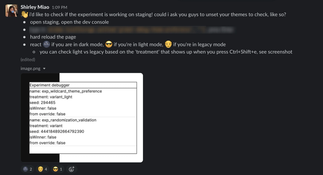

Shortly after Dark Mode Week, we were ready for our internal beta. We automatically fielded each internal user at Figma into one of three modes: dark, light, or legacy. This would help us catch regressions to legacy mode or bugs in either new mode.
Instructions in an internal Slack channel about how to test dark modeInstructions in an internal Slack channel about how to test dark mode
We had a dedicated channel in Slack to test out dark mode and surface any bugs
