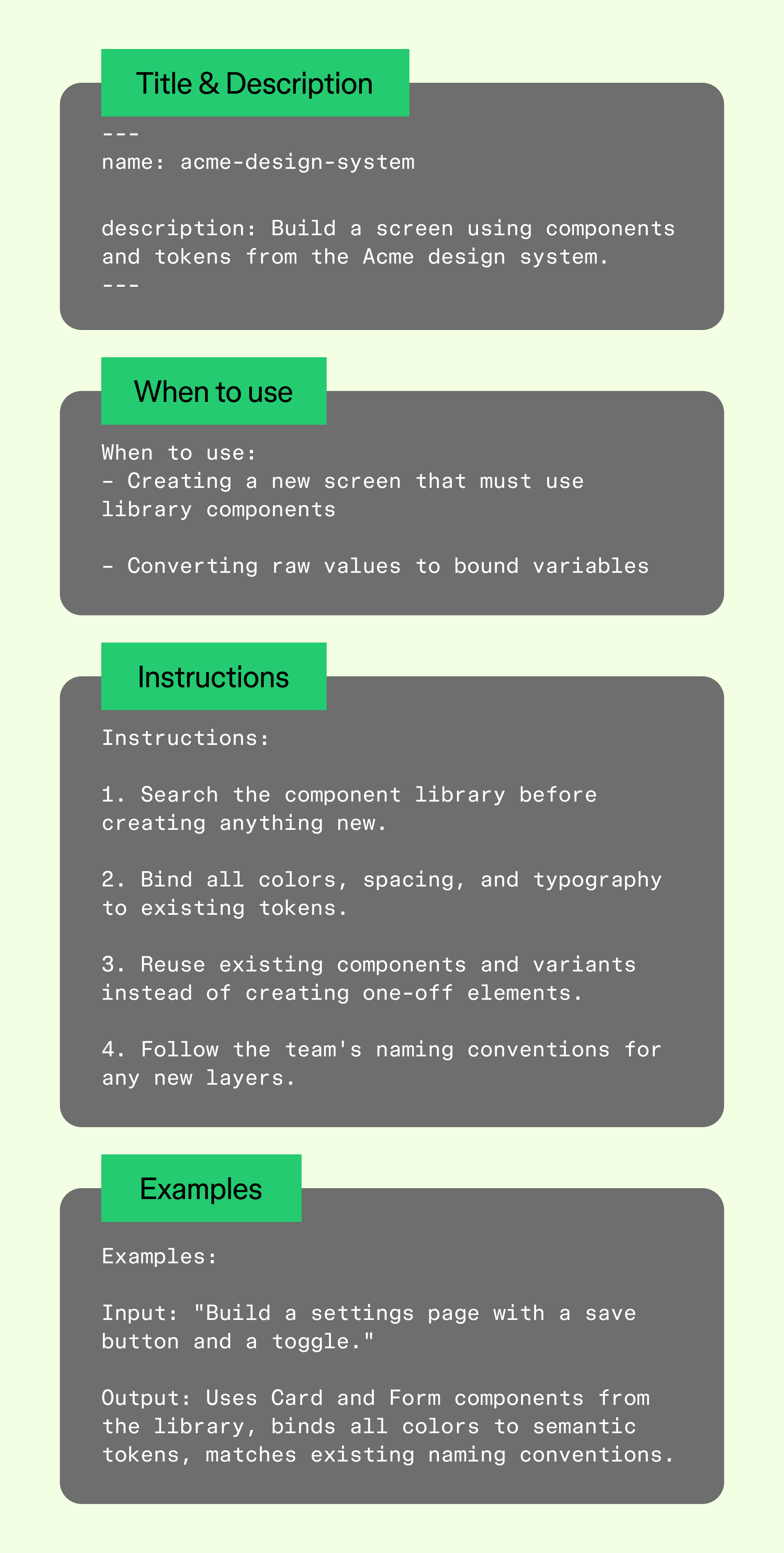

Diagram of a SKILL.md file broken into four labeled sections: title & description, when to use, instructions, and examplesDiagram of a SKILL.md file broken into four labeled sections: title & description, when to use, instructions, and examples

A SKILL.md file follows a consistent structure. Here’s how to build one for your design system:
  • Step 1: Write a clear title and description. Tell the agent exactly what the skill does and when to use it. Something like “Build a screen using components and tokens from the Acme design system” is specific enough to act on.
  • Step 2: Add a “when to use” section. List two or three concrete scenarios where the Claude design system skill applies, like creating a new screen that must use library components, or converting raw values into bound variables.
  • Step 3: Write the instructions as an ordered procedure. Use imperative language and number each step. Put your most important rule first: always search the library before creating anything new.
  • Step 4: Encode your token taxonomy and component rules. Include your naming conventions, semantic versus primitive token guidance, variant structure, and any do's and don'ts pulled from your existing documentation.
  • Step 5: Add at least one concrete example. Show a sample input prompt next to the expected output: what gets created, which components get used, and how tokens get bound.

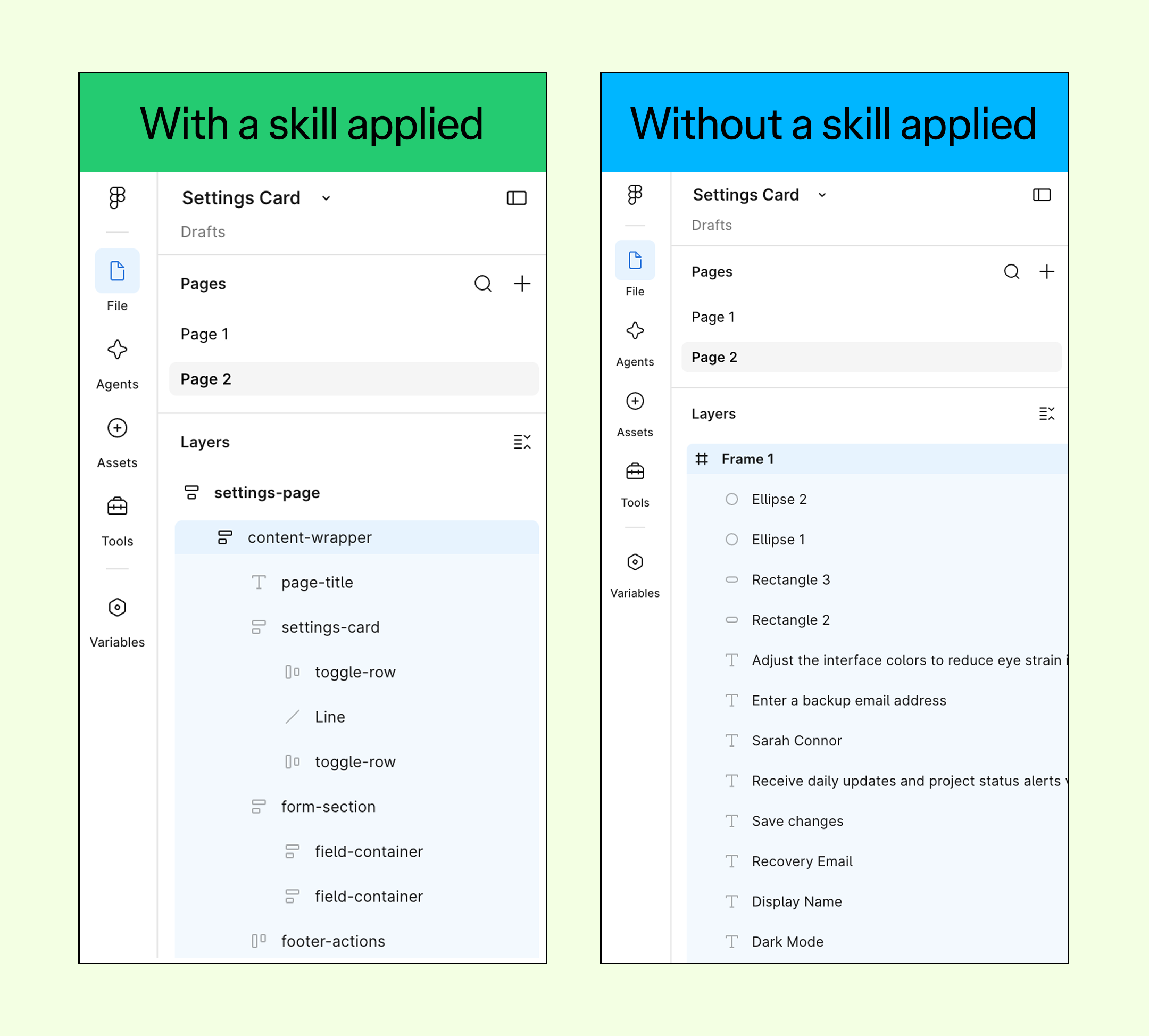

Side-by-side comparison of a Figma settings screen: one built with a Claude Skill and one without.Side-by-side comparison of a Figma settings screen: one built with a Claude Skill and one without.
Example workflow and tips
Say you’re a product designer on a team with an established design system, and you need to build a settings page. Without a skill, the agent produces a screen that looks plausible at first glance but uses hardcoded values that don’t match your system.
With a well-written skill, the agent checks your published library first, finds the Card and Form components already in use, binds every color to a semantic token, and assembles the screen section by section, naming conventions intact.

Example benefit
Brett and Thariq also shared a concrete example from the session. Imagine you have a local folder of JSON files defining your design tokens, including naming and light and dark values, and you ask Claude to generate the corresponding Figma variables.
  • Without a skill: Claude creates a separate variable collection per JSON file—technically working, but not how Figma models light/dark mode (which should be modes within a single collection, not separate collections).
  • With the community “CC Figma tokens” skill applied to the identical prompt: The variables come out structured correctly, with light and dark as modes as expected.
Same prompt, same files—the only difference was the skill.
